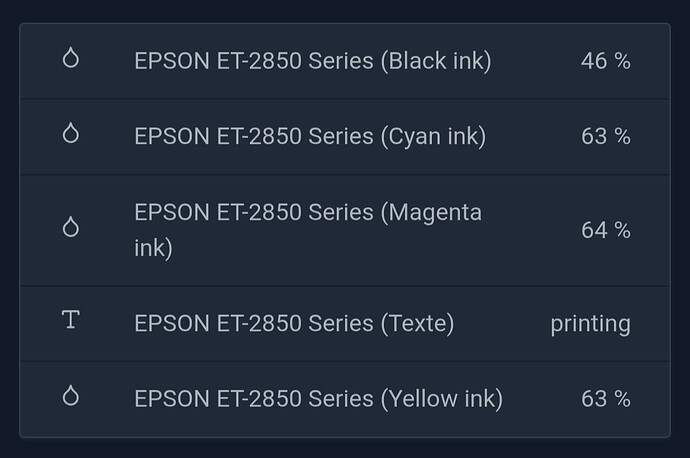

So, I have an Epson ET-2850, do you want me to test it?
I wasn’t planning to add this integration, but if you need to test, let me know :wink:
I’m all for any kind of test ^^
Et voilà !
Nothing to say! Well done! :wink:

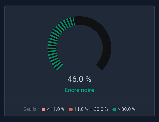

Edit: Nice in gauge:
Thanks for the test! :+1:

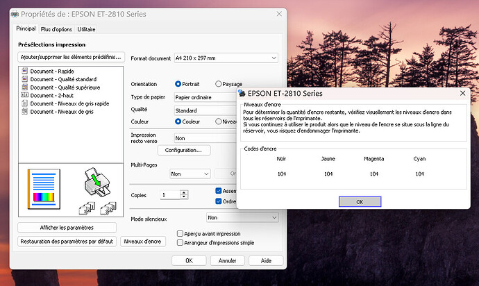

I was so used to my previous printers showing my ink levels on my PC that I didn’t even think to check with this one. It probably doesn’t display its levels as you assumed.
Sorry for the time you wasted.
