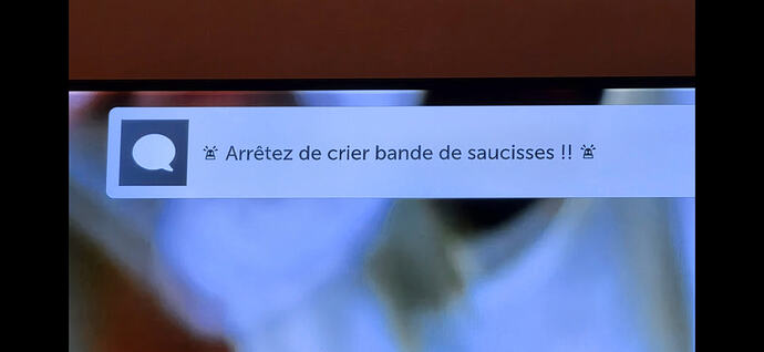

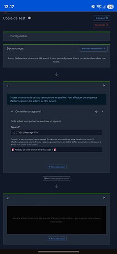

I just connected my TV without any issues!
The feature I’m most interested in would be displaying messages on the TV
 how should I go about testing that?

I’m checking for the notification; I hope I didn’t miss the functionality when switching to multi-TV ^^
@guim31 (no judgment promises) :sweat_smile::rofl:
Well, I did a test on my instance:
I’ll look into your TV :thinking:
@guim31
I think I found the issue:
In your logs, at the moment you send the message, the connection to the TV is cut:
feature=...:toast
clientConnected=false
Just before, you turned off the TV and then tried to turn it back on, but Wake-on-LAN failed because no MAC address is specified. The TV was therefore not reconnected when the message was sent.
The message content and emojis don’t seem to be the problem: I tested them at home with emojis, and the notification displays correctly.
Try with the TV turned on and connected to the integration. (If you’re not connected in the integration, click Test TV connections). Once marked as connected in supervision, you can test sending the notification.
Don’t forget to specify the MAC address, so you can turn it on from Gladys before sending the notification.
You should know that if I turn off or on my TV with the remote, Gladys reconnects properly (I tested it at home).
So I just tested it, I turned on the TV with the remote, I recorded the MAC address. I connected everything correctly.
I was able to send my message and see it (which made my son laugh a lot!).

Hi @spenceur
I just updated to 2.2.3 and, since my TV is off, I had fun testing the connection:
  • Is it possible to have the message in yellow or red (I never know which one is possible) when all (or at least one?) TVs are unreachable?
  • I’ll go so far as to use the singular:
    • Connected when 0 or 1 TV
    • Unreachable when there’s only one TV declared :wink:
Thanks @spenceur for 2.2.4!
We have the right color, we have the right conjugation, but we have English instead of French :frowning:
