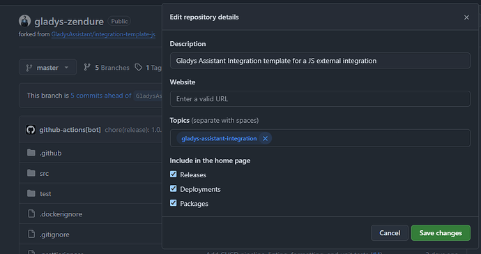

  • On the Zendure side, everything is now functional for this V1 :partying_face: Ready to propose it.
    We even created the issues to move forward and set an implementation roadmap :heart_eyes:
  • On the Tuya side, we’re almost there!! The local functionality works for devices found via UDP (3 out of 10 devices). Commands work both locally AND in the cloud. The only thing left is the status feedback via cloud :sweat_smile:
EDIT: I launched the gladys-zendure release + added the topic, nothing else to do?
