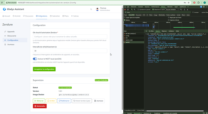

For the « Force Update » button, are you sure you installed the integration with the correct manifest?
Did you copy the manifest from the build?
Oh dear, oh dear, oh dear, it’s working way too hard here
Yes, in this case, 100% sure.
The only time the manifest changed, I found it logical and instinctively deleted and recreated it. If it’s possible in dev, to modify the manifest directly from the integration or even better if it checks/reloads itself would be even better (especially for testers), but here I’m just asking about feasibility ^^
And in this case:

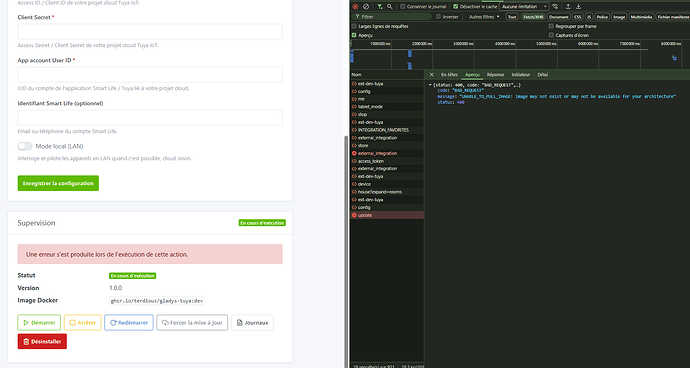

  • If no production image (Tuya), the dev update creates an error:

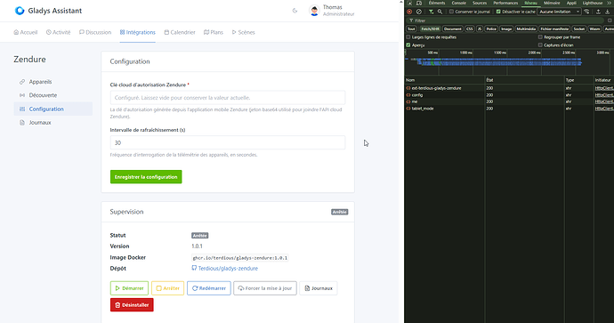

  • If a production image is active (Zendure), the container update loads the production image and overwrites the dev (annoying ^^) => See the Docker image version below after clicking update vs the address http://10.5.0.227:1444/dashboard/integration/device/external/ext-dev-zendure-2/config which indicates that I was on the dev image
    => the production address is http://10.5.0.227:1444/dashboard/integration/device/external/ext-terdious-gladys-zendure/config
Ouch ^^ :face_with_peeking_eye:

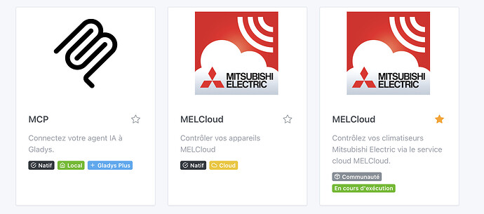

It is now possible to favorite a community integration:

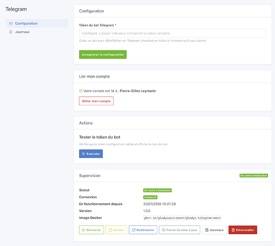

Ok, I’ve made progress on the « Communication » type integrations (e.g.: Telegram), and it’s available in SDK v0.6.0.
I just ported the Telegram integration with Fable in one go, and it works perfectly.
I even find the experience better than the integration we have in Gladys :joy:
