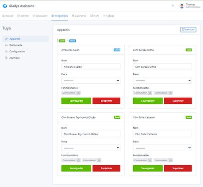

UX feedback after putting the transport model + actions into service on gladys-tuya (by the way: the local/cloud badges, the GLADYS_PREFER_LOCAL toggle, the upsert of params, and the detect_protocol action all work perfectly in real life — bravo, it’s a game-changer).
The remaining difficulty is the DEVICE-SIDE READABILITY. Scenario experienced by a regular user: two devices display a « Cloud » badge while the local mode is enabled. Why? One wasn’t found by the UDP scan (no IP), the other refuses local sessions. Impossible to know from the device card: it only displays Name / Room / Features (DeviceBox.jsx doesn’t render any param outside the GLADYS_TRANSPORT badge).

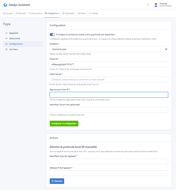

  2. DEVICE-SPECIFIC ACTIONS: today, the actions from the manifest are only rendered in the Configuration screen (ActionsCard.jsx), at the integration level.
    To « detect the local protocol, » the right place is the card of the concerned device: a « scope »: « device » flag on the action, rendered as a button on each card, with the device’s external_id injected into the fields transmitted to the integration. This would avoid asking the user to copy an identifier.
  3. Failing that (or as a complement), a DYNAMIC SOURCE for the select fields of actions: today, ConfigSchemaForm.jsx only renders static options from the manifest. A field { "type": "select", "source": "devices" } listing the devices created by the integration (label = name, value = external_id) would solve 90% of the need with minimal front-end changes.
In the meantime, we’ve put a workaround on the integration side: the action field accepts the NAME of the device as displayed in Gladys (or the Tuya ID). It’s a temporary fix, but it’s still free-form input with the risks of homonyms.
Additional note on transport badges — a « degraded » state (orange)
By using the local/cloud badges in real life, we encounter a case that the current three states (local / cloud / unreachable) cannot express: the device WORKS, but not as it should.
Concrete case experienced: a device is correctly identified by the local UDP scan (IP and protocol version known, local mode enabled), but it returns errors or timeouts on local reads. Our integration then falls back to cloud: the user sees a blue « Cloud » badge, perfectly normal in appearance… when in reality something is wrong (device refusing local sessions, rotated local key, another local client holding the connection, etc.). Nothing invites them to investigate.

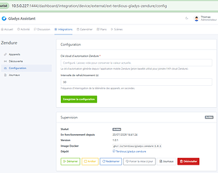

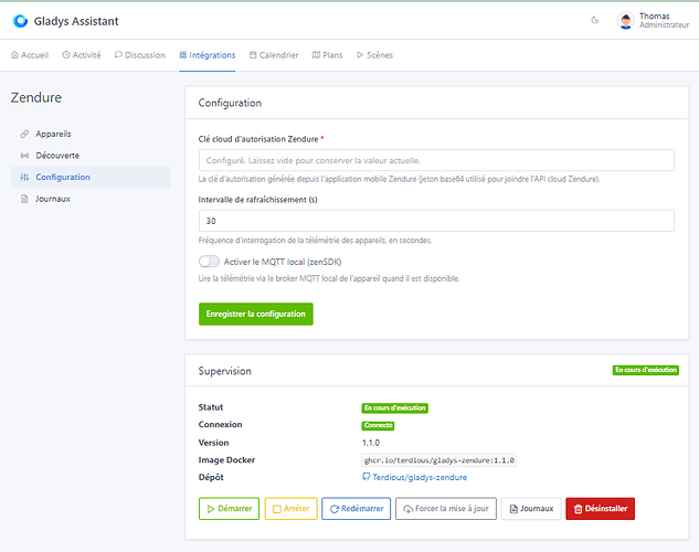

Otherwise, I only have the documentation left to write, but the first two external integrations seem ready to be released ^^:
  • gladys-zendure in v1.1.0
The update works great!!^^
  • and gladys-tuya in v1.0.1:

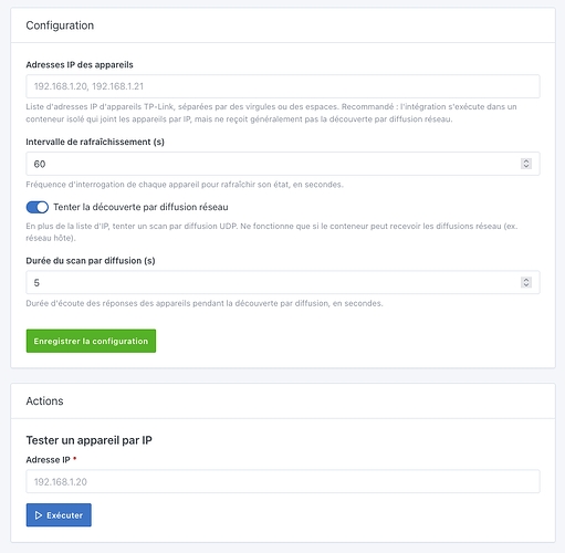

Yes, that’s what I did, but the proposal needs to be reviewed (IP to be entered by the user and fallback on network scan). I would like it to be simpler and therefore understand what is really possible with the scan (I will reread the documentation).
Wouldn’t the Supervision section benefit from being in a separate part (outside of configuration)?

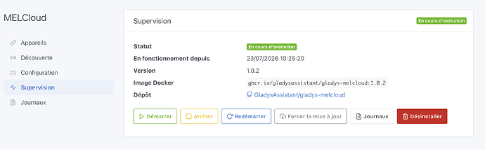

Dedicated Supervision Tab (Thanks @cicoub13)

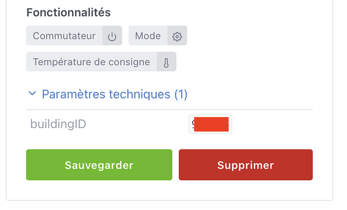

Ability to view the params:
I totally agree with that, and as mentioned for point 1, it works without it, it’s « just » possible improvement, to discuss and take the time :smiling_face_with_three_hearts:
It’s much better :wink:
