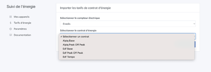

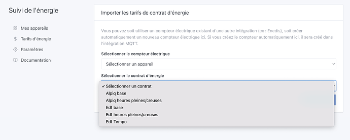

I’ve merged Alpiq, for now only the consumption part since I don’t manage the subscription part:
I’ll take care of adding the subscription when it’s handled :slight_smile:

hummm, for the French Peak Off Peak doesn’t mean anything, it’s more like HC/HP.
Is there a way to have that in the selection menu?
Yes, good idea!
It’s done!
