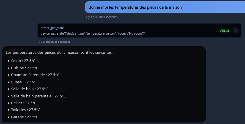

In the discussion, the AI indicates humidity levels in the kitchen where no sensor or probe is present.
AI’s response to the question: « Humidity in the house »
The humidity in the house is 52.0% in the living room, 51.7% in bedroom 1, 52.2% in bedroom 3, 52.3% in the kitchen, 52.5% in the bathroom, 52.7% in the technical duct, 52.8% on the north balcony, and 52.9% on the south balcony.

Everything is wrong: the sent GET request is not correct
Thanks for your feedback, it helps me iterate on these silly little bugs
