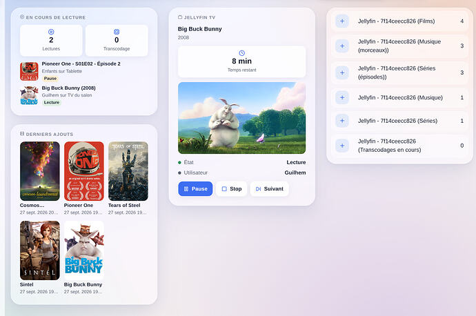

[screenshot of the dashboard]

  • Now playing: who is watching what, where, with the posters
  • Player: the current playback in remote control (background image, title, remaining time, buttons). Blank setting = it follows what is playing; or choose a specific player
  • Recently added: the posters of the latest movies, series or albums, the new episodes grouped by series
