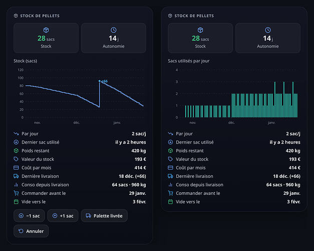

I heat with a pellet stove, and I was tired of going to the garage to count the bags to know if I needed to reorder. So I developed an external integration for Gladys: Pellet Stock.
It tracks your pellet stock: deliveries, consumption, average daily consumption, remaining autonomy, and if you indicate the price of a pallet, the stock value and the monthly cost. There is no hardware to install or online account to create. The integration simply keeps a record of bag movements and calculates the rest from there.
Everything happens in a widget on the dashboard. You can see your stock (green, then orange below the low stock threshold, red at zero), your autonomy in days, the date to reorder, and a graph of the stock evolution or bags used per day. On a daily basis, you just need to press « −1 bag » each time you refill the stove and « Pallet delivered » each time a delivery is made.
The integration is also used in scenes. For example, a Zigbee button placed next to the stove can remove a bag with each press, and Gladys can send you a message when the stock is low. If you have a second home, you can track multiple stocks separately.

I don’t know if it’s a rounding issue, but the season cost of 11€ doesn’t match 2x5.45€ which makes 10.90€
I think it’s a rounding issue. I’ll look into it as soon as possible.
Well spotted, thanks! The calculation was correct, it was the display that rounded to the euro.
In the next version, amounts will be displayed to the cent (€10.90). The same goes for the total stock value
I took the opportunity to shorten the « Stock Value » line, which was cut off: it now only displays the value and the price per bag.
