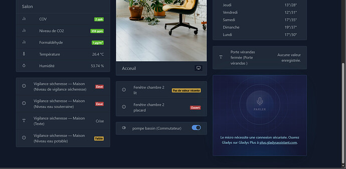

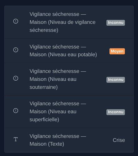

I notice that in the configuration I have all this text displayed:
However, on my dashboard I see this:
I thought that for the text feature, I would have other values than crise
Is this intended?
Yes, that’s normal regarding the current restrictions. For now, we display it here, but we could later have it displayed in a text feature.

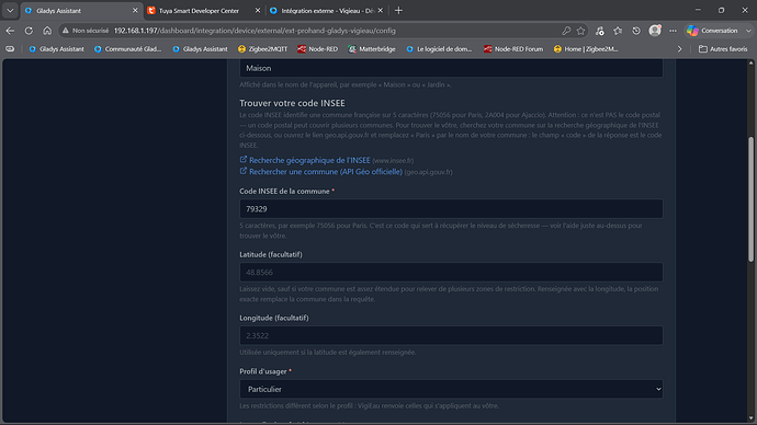

Can you take a screenshot of the config section for me, please?
Ok thanks for your reply.

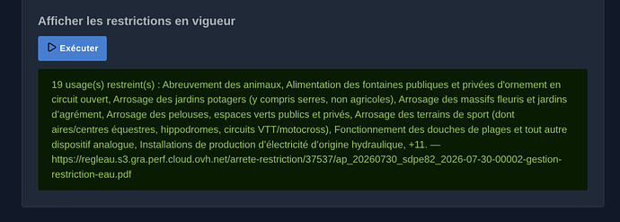

[2026-08-05T10:01:30.308Z] [INFO] [drought-zone] Read: level=4 (SUP=4 SOU=4 AEP=2), 19 restricted usage(s)
[2026-08-05T10:01:38.206Z] [INFO] Action rechercher_commune <- ma-commune
[2026-08-05T10:01:42.151Z] [INFO] [drought-zone] Action test_vigieau -> live request to the VigiEau API
[2026-08-05T10:01:44.636Z] [INFO] [drought-zone] Action show_restrictions -> live request to the VigiEau API
[2026-08-05T10:01:54.895Z] [INFO] onDeviceCreated -> ext:ext-prohand-gladys-vigieau:drought-zone:commune-82005, refreshing right away
[2026-08-05T10:01:54.896Z] [INFO] [drought-zone] Polling VigiEau for Maison...
[2026-08-05T10:01:54.965Z] [INFO] [drought-zone] Read: level=4 (SUP=4 SOU=4 AEP=2), 19 restricted usage(s)
[2026-08-05T10:03:16.292Z] [INFO] [drought-zone] Action show_restrictions -> live request to the VigiEau API
[2026-08-05T11:01:30.193Z] [INFO] [drought-zone] Polling VigiEau for Maison...
[2026-08-05T11:01:30.291Z] [INFO] [drought-zone] Read: level=4 (SUP=4 SOU=4 AEP=2), 19 restricted usage(s)

I looked on the vigieau website and apparently there is no alert other than drinking water for your INSEE code, you can check directly on the vigieau website so by default it goes to unknown:
Perhaps it would be more relevant to display « No risk »

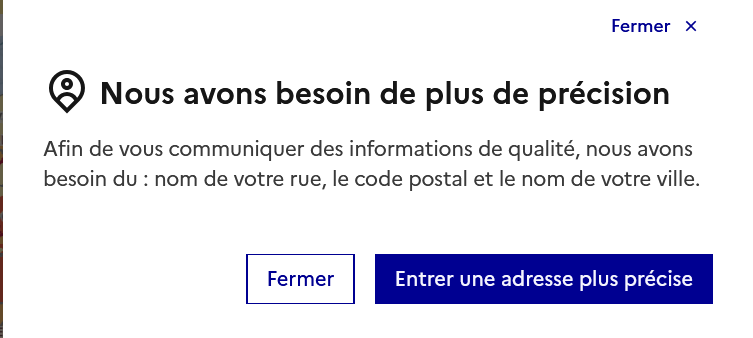

When we look on the vigieau website, we get this message when trying to view alerts for your commune:
I’ll also get claude to work on the subject :wink:
And it’s in progress :wink:
I’ll keep you posted when the new version can be released
I published a version that fixes the 409 error
Basically, you no longer need to enter the INSEE code but the address
The latitude and longitude are automatically filled in
To get the correct alerts, I recommend entering at least the name of your street + postal code + city
If you only enter your city, it will take the city center and the alerts may be incorrect.
