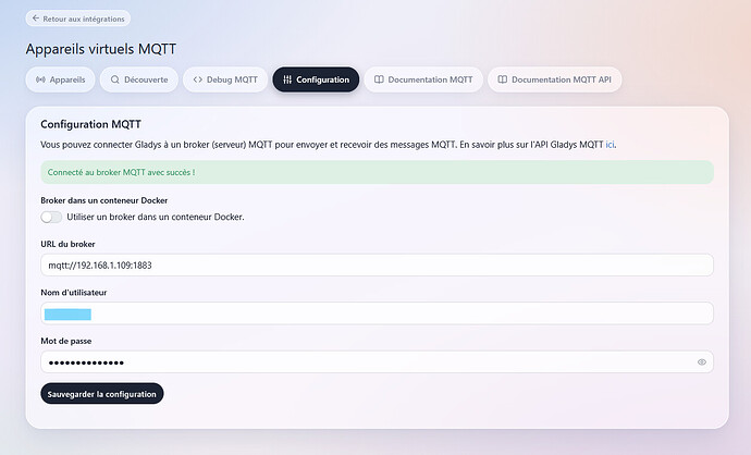

My config:
I have version 5.0.4 under Unraid (Docker), the MQTT client is connected to the broker of my HA instance. My sensors, etc., are updated correctly in Gladys, so I don’t see why I keep getting this connection error that keeps popping up?
Thanks!
