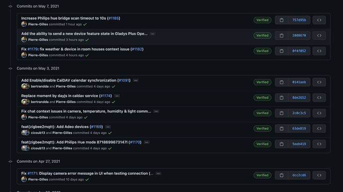

Here’s what’s new:
In French, that means:
  • Fixed the Philips Hue scan issue for some users by increasing the timeout, which was too low.
  • Fixed the bug where rooms would disappear when the « room device » box was used at the same time as the « weather » box.
  • It is now possible to disable the synchronization of a Caldav calendar.
  • Fixed the chat bug that appeared after the node-nlp library update in Gladys. Please check that all available phrases in Gladys work well!
  • New Zigbee2mqtt devices have been added.
  • When there is a connection problem with a camera, the UI now displays the error!
