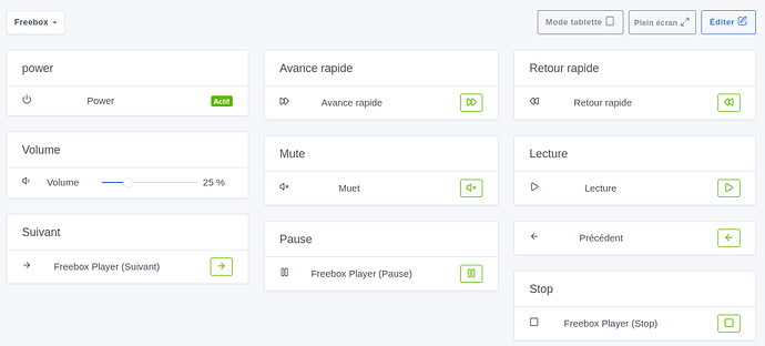

I created a scene for the shutters, and it works very well and is very practical. Thanks again!

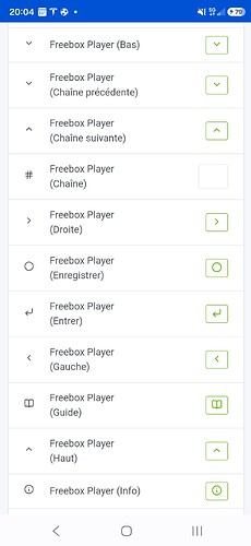

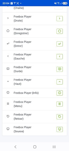

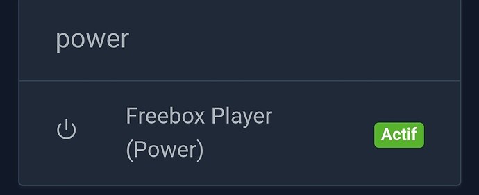

Here is the power button:
Don’t hesitate to share your oogs so I can try to fix your problems.
For the buttons, they are MQTT virtual buttons because my player is not compatible.

Thanks for the logs.
You can show me the actions you have available and tell me what happens.
Take a screenshot of all the actions of your player from the discovery page.
  1. When I power on the player (Devialet), the following home screen appears:
Then, no button on the dashboard can trigger an action:
  1. I then take the player’s remote control, select Home, which triggers the last channel in memory.
  2. I press the « mute » button on the dashboard, the sound cuts out, but when I click again, the sound does not return even by adjusting the volume.
  3. I restore the sound with the player’s remote control
  4. I adjust the sound volume up and down with the dashboard slider, it works well,
  5. I press the next button, nothing happens,
  6. I press the previous button, nothing happens,
  7. I go back with the player’s remote control on the << button and press the fast-forward button on the dashboard, it works well click by click,
  8. I press the rewind button on the dashboard, it works well click by click,
  9. I press the stop button on the dashboard and the player turns off, completely powers down.

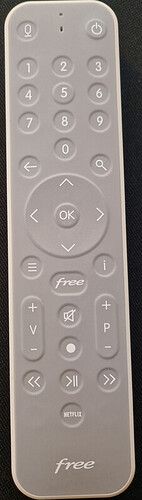

For point 1, we would need the equivalent of the « OK » button in the center of the remote control
For points 6 and 7, we would need the equivalent of the « + » and « - » keys for the programs on the remote control.

Thanks a lot @Jluc,
The buttons — « Next » / « Previous » don’t change the channel
These two buttons are media playback commands (next track or chapter)
I added, as you requested, the equivalent of the P+ and P− keys: « Next Channel » and « Previous Channel ». And as a bonus, a « Channel » feature where you directly enter the number (1, 2, 27…) — it’s the only channel-hopping method officially documented by Free, so the most reliable of the three.
I added the OK button you asked for, plus the directional arrows, Back, Home, Guide, Info, and TV.
For the sound that doesn’t come back: it was a real bug
The « Mute » button sends the same value with each press, and my code stupidly deduced « mute the sound » every time — hence the sound never coming back.
Now the integration reads the player’s actual state before acting and reverses it: one press mutes, the next press restores. The state is also immediately sent back to the dashboard, so it no longer remains displayed upside down.
Play and Pause
The Freebox API only exposes a single command that toggles play/pause. My two buttons were actually sending non-existent commands. They now work, but both do the same thing (toggle).
The Stop that turns off the player
I have no explanation. The official documentation describes stop as a simple playback stop, without a word about turning it off.
If it happens again, the logs will tell me: I added detailed tracing of each command sent to the Player, which was completely missing until now (that’s why your previous logs showed nothing when you pressed the buttons).
Be careful with the Free API:
The navigation keys (arrows, OK, Back, Home, Guide, Info, Channel +/−) go through an undocumented entry point by Free, derived from community reverse engineering. They work, but may stop working after a Freebox update. What is guaranteed by the official documentation: power, volume, mute, channel by number, and playback commands. This is indicated in the integration documentation.
Also fixed along the way
  • The logs displayed Freebox set « undefined » instead of the device name — fixed.
  • Your nighttime error on the « Balcony Camera » (Error when loading first segment): it’s an expired video segment between the moment the Freebox announces it and when we read it. The integration now automatically retries once, which should make the warning disappear.
All this will arrive in the next version. When you have it, you’ll need to restart a discovery to get the new Player features (they won’t appear automatically on already created devices).
And if you can retest the Power button at that time, I’m interested
Thanks again for your tests, it was really precious :folded_hands: I’ll keep you informed when the release is ready
