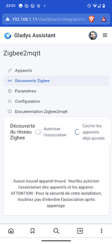

The page loads.
On mobile, it’s a bit cramped.
The button doesn’t work. I’ll test it on a computer tomorrow to give you more details.
