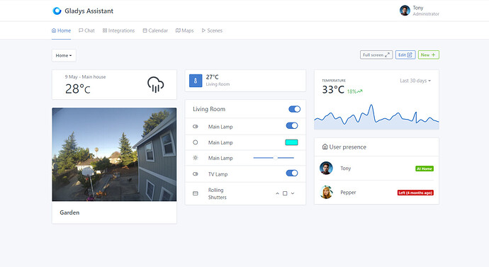

I made a mockup with both, knowing that the percentage would only be used for those that support it:
In my opinion, it looks great! Great mockup by the way :slight_smile: The full square « stop Â» button could perhaps be improved a bit?

Yes, see if square outline
