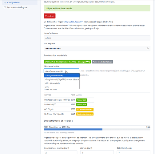

Image update with the possibility to select the Google Coral (with auto-detection and auto-selection if present):

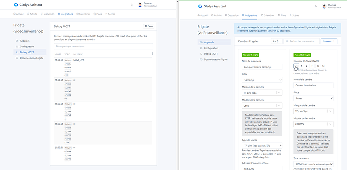

PTZ control tested and functional, for now in the device sheet to test ^^:
  • a debug view to see what’s happening. The movement and stop are instantaneous

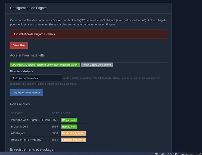

With this error:
{"status":404,"code":"NOT_FOUND","message":"Route /v1/service/frigate/connect not found"}
Hi @Will_71,
Not really understanding this error, I asked Fable to look into the code to find an issue on this route. I’m pasting what he gave me, if you can answer the 4 questions, even though I suspect it has nothing to do with Gladys Plus:
Problem Diagnosis — two distinct issues, and no bug detected in our code:
1. The 404 error is the signature of an access via the Gladys Plus tunnel, not a local access. Three facts verified in the code:
  • The route POST /api/v1/service/frigate/connect exists in all versions since PR1 (I regenerated the route table of the controller to confirm).
  • A local 404 would display the path with /api (the Express router is mounted at the root with full paths). Its message shows /v1/service/frigate/connect without /api.
  • This format is produced in only one place: setupGateway.js:74, the handler for Gladys Plus requests — its instance received via the tunnel a non-prefixed URL, which doesn’t match anything.
In other words: something on his end is calling the API via the gateway with a truncated URL — our front never sends that (nor does the official front). Suspects: access via plus.gladysassistant.com instead of the local IP, mobile app, or an old bundle in cache.
2. The « installation failed » banner is a separate issue: on his end, the boot init went as far as port allocation (they are displayed: 8971/1885/5000/8554) then failed to install the Docker containers. Common causes: /var/run/docker.sock not mounted in his docker run command, non-host network, or impossible image pull.
To ask him on the forum:
  1. His full docker run command (it needs -v /var/run/docker.sock:/var/run/docker.sock and --network=host).
  2. The logs docker logs <gladys> around the click on Activate.
  3. Which URL he uses to access Gladys for this test: local IP (http://IP:port) or plus.gladysassistant.com? For this test phase, he needs to go through local access (the Frigate UI is only accessible in LAN anyway).
  4. If the 404 persists locally: the Network tab of the browser on the connect request (exact URL, method, status).

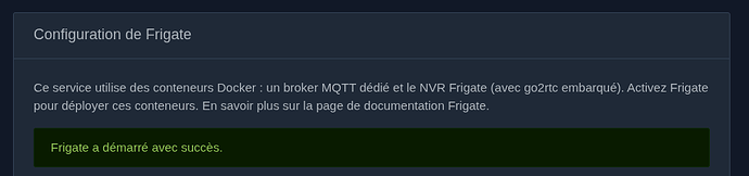

So it’s not directly a problem with Frigate, but I managed to start the installation
The problem was my instance. I launched Gladys without the Mosquitto container created with Gladys, for information it’s on my laptop where I do all the tests, not my production. So the MQTT integration was in error and it was therefore impossible to activate Frigate.
Once the MQTT container was OK, the installation went through
I do have something strange though, as the container keeps restarting in a loop
Here are the logs:

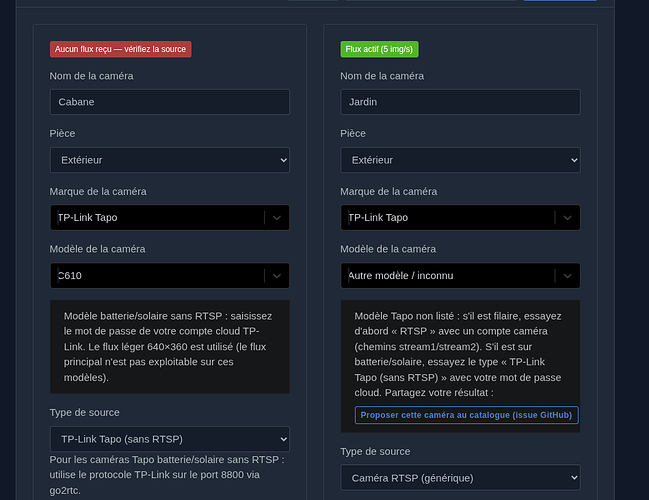

The front end works, it’s strange. However, it’s impossible to add cameras! Strange
Visual bug: when you reduce the window there is a slight offset
Found it!! It’s my fault, we were only managing Intel GPUs. It saw a GPU so it switched to GPU config. Try changing to CPU, that should do it. On our side, we’re fixing the issue. Thanks for this test :sweat_smile: :grimacing:
The front end and the inability to register devices come from the same issue.
To properly fix the auto-detection (it’s a real bug on our side, we won’t offer the GPU mode anymore except on compatible chips), could you give me the CPU/GPU model of the laptop? For example, the result of lspci | grep -iE 'vga|3d' .
For adding cameras: they must be added from Gladys (Frigate integration → Devices tab), not from the Frigate web interface — Gladys manages the camera configuration and would overwrite what is added on the Frigate side. Once the detector is set to CPU, you should be able to add your first camera from Gladys without any issues.
Here is the result of the command:
I’ll check the CPU details tomorrow. I’ll keep you posted.
Thanks @Will_71,
The image updates with the fixes. But if you can test running on CPU before updating to check that it restarts properly, that would be great ^^

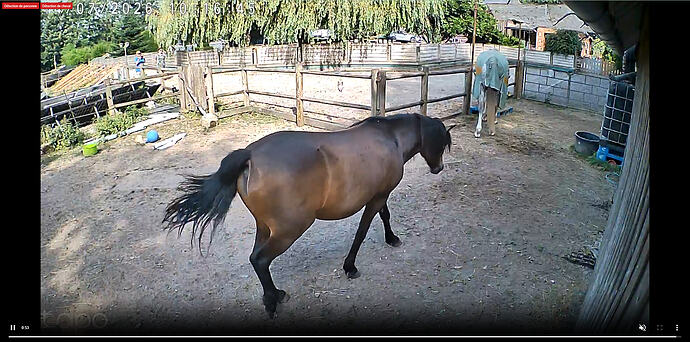

Detection example:

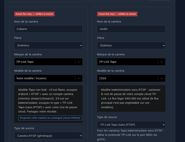

So I switched to CPU. I didn’t update the image.
In CPU mode, my laptop struggles at container startup, and consequently Gladys does too.
When I made the change, I got an error
and after that, I think it restarted.
However, my cameras are not working.Here are the frigate logs
0/rawvideo @ 0x556612c98740] Nothing was written into output file, because at least one of its streams received no packets.
2026-07-14 10:33:55.201515251  [2026-07-14 12:33:55] watchdog.cabane                INFO    : Restarting ffmpeg...
2026-07-14 10:33:55.224557860  [2026-07-14 12:33:55] watchdog.jardin                ERROR   : Ffmpeg process crashed unexpectedly for jardin.
2026-07-14 10:33:55.224833151  [2026-07-14 12:33:55] watchdog.jardin                ERROR   : The following ffmpeg logs include the last 100 lines prior to exit.
2026-07-14 10:33:55.225081438  [2026-07-14 12:33:55] ffmpeg.jardin.detect           ERROR   : [rtsp @ 0x55c7178bc440] method DESCRIBE failed: 404 Not Found
2026-07-14 10:33:55.225260249  [2026-07-14 12:33:55] ffmpeg.jardin.detect           ERROR   : [in#0 @ 0x55c7178bc100] Error opening input: Server returned 404 Not Found
2026-07-14 10:33:55.225442011  [2026-07-14 12:33:55] ffmpeg.jardin.detect           ERROR   : Error opening input file rtsp://127.0.0.1:8554/jardin.
2026-07-14 10:33:55.225549234  [2026-07-14 12:33:55] ffmpeg.jardin.detect           ERROR   : Error opening input files: Server returned 404 Not Found
2026-07-14 10:33:55.225726670  [2026-07-14 12:33:55] watchdog.jardin                INFO    : Restarting ffmpeg...
2026-07-14 10:33:55.257028264  12:33:55.256 WRN [rtsp] error="streams: 401 Unauthorized" stream=jardin
2026-07-14 10:33:55.258524913  [2026-07-14 12:33:55] frigate.video                  ERROR   : jardin: Unable to read frames from ffmpeg process.

I am updating the image
Well, with the image update, I have some good news
I have 1 camera working. The battery-powered one remains
Which other model do you have? Does it support ONVIF? RTSP only?
The C610, I have the C660, it works, maybe there are some nuances. Apparently, some won’t work because it drains the battery. I’m trying to find a workaround because in my case, my battery-powered cameras are always powered. The battery only serves as a backup in case of a power outage.

My working camera model is a weird C500 that it’s not listed! It supports both protocols.
For the C610, it’s a battery-powered model but with a solar panel that recharges the battery. Did you modify any parameters with your permanent power supply? Some have an „always active“ mode parameter when they are directly powered
I have a generic camera also connected to my Freebox via Wi-Fi and it works
Yes, the list is not exhaustive for now, it was for the first draft :sweat_smile:.
Yes, that’s exactly the issue ^^ I tested with the C660, not powered, battery full at 7 p.m., it completely drained by 2 a.m… that’s also why they usually don’t activate RTSP/ONVIF on battery cameras.
We’ll first add a warning message to alert about the danger when running entirely on battery.
Then we’ll see if settings can be adjusted to avoid continuous streaming. But the issue for a camera is indeed there. They go into standby and it’s them that contact the app in case of an alert or something. Whereas for Frigate, it has to wake it up every time!!
Great!! RTSP only?
The opposite is also true because the TAPO app wakes up the camera when you want to see the video stream
yes
@Will_71,
Two distinct issues in your logs :slightly_smiling_face:
  1. Cabane (C610): The error Failed setup for format vaapi / h264 profile 77 comes from hardware decoding that was using your NVIDIA card instead of the Intel GPU (bi-GPU bug fixed in the image you’re installing). After the update, these errors should disappear — if you still see them, send us the logs. And since your C610 is on solar power: make sure to activate the « always active / continuous monitoring » mode in the Tapo app, it’s designed for cameras with live power.
  2. Jardin (C500): The 401 Unauthorized is the camera refusing the credentials. For wired Tapo cameras, you need to create a « camera account » in the Tapo app (camera settings → Advanced settings → Camera account) and enter THOSE credentials in Gladys — not your TP-Link cloud account. Good news: the C500 is added to the catalog, in the next image you’ll be able to select it directly (paths and note pre-filled).
  3. The « Frigate installation failed » followed by « started successfully »: transient hiccup on restart, we plan a more explicit message.
I just built a new image, you can get it.
