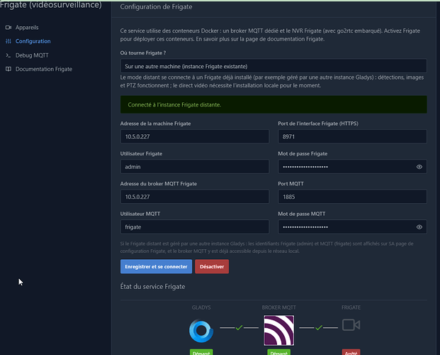

@prohand (and @Will_71 if you want to test on a remote machine or next to it on another image), For info, I just deployed a new image docker pull terdious/gladys:Frigate-test-externe for the external Frigate.
Note, not finished yet, but it works ^^

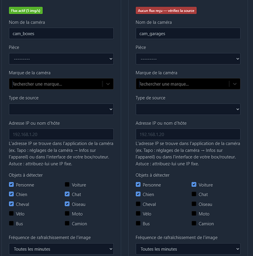

Good news: the GPU decoding errors have disappeared, the update fixed that part. What remains on the C610 is a camera authentication refusal (401 Unauthorized). Two things to try: 1) in the camera’s card in Gladys, set the « Authentication Variant » to SHA256 then save — some recent Tapo battery firmwares no longer accept the cloud password in plain text; 2) if still 401, recheck the TP-Link cloud account password (the one from the Tapo app), and close the Tapo app during the test (simultaneous stream limit). No problem for the missing « always active » mode: the 401 is an authentication refusal, not a sleep mode. For the C500, let us know how it goes now that it’s in the catalog.
=> The new image is built
For the C610, I already tried, but without success.
For the C500, it worked without and it works with.
I’m currently installing your latest image: what did you modify?
Something has changed because in Frigate it is now searching, unlike before where I had an error message
but in the logs, the same errors persist
2026-07-14 14:26:23.463820500  16:26:23.463 WRN [rtsp] error="streams: 401 Unauthorized" stream=cabane
2026-07-14 14:26:23.475466636  [2026-07-14 16:26:23] frigate.video                  ERROR   : cabane: Unable to read frames from ffmpeg process.
2026-07-14 14:26:23.483274406  [2026-07-14 16:26:23] frigate.video                  ERROR   : cabane: Unable to read frames from ffmpeg process.
2026-07-14 14:26:23.489258010  [2026-07-14 16:26:23] frigate.video                  ERROR   : cabane: ffmpeg process is not running. exiting capture thread...
2026-07-14 14:26:31.511008839  [2026-07-14 16:26:31] watchdog.cabane                ERROR   : Ffmpeg process crashed unexpectedly for cabane.
2026-07-14 14:26:31.512087672  [2026-07-14 16:26:31] watchdog.cabane                ERROR   : The following ffmpeg logs include the last 100 lines prior to exit.
2026-07-14 14:26:31.512526498  [2026-07-14 16:26:31] ffmpeg.cabane.detect           ERROR   : [rtsp @ 0x55c08a502440] method DESCRIBE failed: 404 Not Found
2026-07-14 14:26:31.513245505  [2026-07-14 16:26:31] ffmpeg.cabane.detect           ERROR   : [in#0 @ 0x55c08a502100] Error opening input: Server returned 404 Not Found
2026-07-14 14:26:31.514667154  [2026-07-14 16:26:31] ffmpeg.cabane.detect           ERROR   : Error opening input file rtsp://127.0.0.1:8554/cabane.
2026-07-14 14:26:31.515663069  [2026-07-14 16:26:31] ffmpeg.cabane.detect           ERROR   : Error opening input files: Server returned 404 Not Found
2026-07-14 14:26:31.516321781  [2026-07-14 16:26:31] watchdog.cabane                INFO    : Restarting ffmpeg...
Sorry for the back and forth!! And a big thank you for your tests.
Can you do a docker exec gladys-frigate curl -s http://127.0.0.1:1984/api/streams | python3 -m json.tool The cabane section will precisely tell what the camera is responding (wrong password, handshake failure…).
EDIT: Be careful, there are passwords in the sections!
The « ça cherche » is actually proof that the update fixed the GPU decoding: before, the pipeline crashed immediately (hence the error message); now it starts correctly and waits for images. As your C610 still refuses authentication (the 401 Unauthorized in the logs), no images arrive — hence the infinite wait. So there’s only one problem left: the cloud password for this camera. Send us the result of docker exec gladys-frigate curl -s http://127.0.0.1:1984/api/streams | python3 -m json.tool (section cabane) so we can see exactly what it responds — and tell us if your Tapo account is a Google/Apple account (in this case you need to create a real TP-Link ID password, that’s what the camera expects).
No problem, I told you I would do tests so it doesn’t bother me at all.
"cabane": {
        "producers": [
                "url": "tapo://password_tpcloud@ip_caméra?channel=0&subtype=1"
        "consumers": null
I replaced my password and the IP!
It’s a TP-Link account, I never go through Google/Apple
Well… ok… let’s try again ^^ There’s no information^^
So don’t be offended by the first question, Fable wants to check everything ^^ :
  1. Are you the owner of the camera in the Tapo app, or is it shared with you? The local stream only accepts the password of the owner account — a guest/shared family account will give exactly this refusal.
  2. To see the exact exchange, enable detailed go2rtc logs from the Frigate UI (no terminal needed): open the Frigate interface → configuration editor (pencil icon) → add under the existing go2rtc: section:
go2rtc:
  log:
    level: debug
→ save/restart, then check the Frigate logs: the tapo lines will tell if it’s a password refusal or a protocol issue (C610 firmware too recent for the go2rtc of Frigate 0.17.2 — in this case we’ll report it upstream and note it in the catalog).

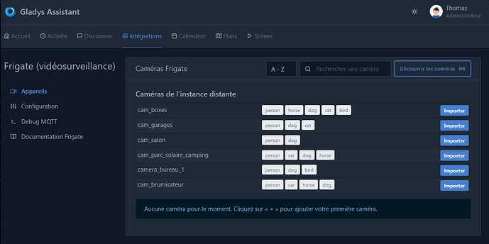

Hi @ProtZ,
Do you mean external? If so, I already have a test image if you want to test
It will be updated in about 5 minutes available ^^

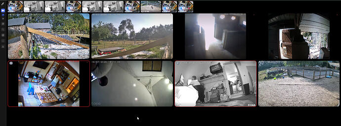

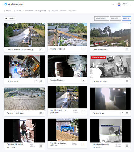

It’s starting to become quite nice ^^ (Sorry for showing off in public ^^
If only the desktop view could be wider :sweat_smile: 5 columns would be perfect!!

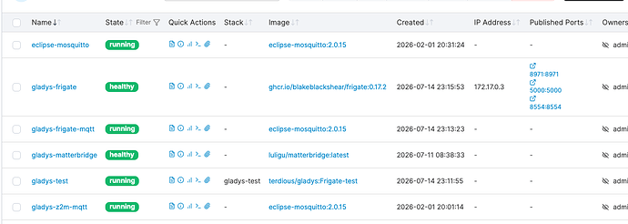

Hi! I just ran a test from the image and I have a crazy bug… When I click on the service configuration page, without having added a camera (Edit: even after), on enable I get this in the logs 2026-07-14T22:08:48+0200 <info> setEnabled.js:12 (FrigateManager.setEnabled) Frigate: setting integration enabled = true 2026-07-14T22:08:48+0200 <info> system.isDocker.js:13 (System.isDocker) System.isDocker: This system is running inside Docker. 2026-07-14T22:08:48+0200 <info> detectHardware.js:78 (FrigateManager.detectHardware) Frigate: no compatible render node found, video decoding on CPU 2026-07-14T22:08:48+0200 <info> allocatePorts.js:33 (FrigateManager.allocatePorts) Frigate: allocated port 1885 for MQTT broker 2026-07-14T22:08:48+0200 <info> allocatePorts.js:33 (FrigateManager.allocatePorts) Frigate: allocated port 8971 for Frigate UI 2026-07-14T22:08:48+0200 <info> allocatePorts.js:33 (FrigateManager.allocatePorts) Frigate: allocated port 5000 for Frigate API 2026-07-14T22:08:48+0200 <info> allocatePorts.js:33 (FrigateManager.allocatePorts) Frigate: allocated port 8554 for Frigate RTSP restream 2026-07-14T22:08:48+0200 <info> checkForContainerUpdates.js:14 (FrigateManager.checkForContainerUpdates) Checking for current installed versions and required updates... 2026-07-14T22:08:48+0200 <info> checkForContainerUpdates.js:18 (FrigateManager.checkForContainerUpdates) Frigate MQTT container: update #1 of the container required... 2026-07-14T22:08:48+0200 <info> checkForContainerUpdates.js:32 (FrigateManager.checkForContainerUpdates) Frigate MQTT container: update #1 of the container done 2026-07-14T22:08:48+0200 <info> checkForContainerUpdates.js:37 (FrigateManager.checkForContainerUpdates) Frigate container: update #1 of the container required... pi@gladys:~$ And… The Gladys container self-deletes! Nothing left, Nada! I tried three (four) times thinking I made a mistake… The folder containing the DB is also emptied. I’m on a Beelink S13 with 16GB RAM The command used is: sudo docker run -d --log-driver json-file --log-opt max-size=10m --cgroupns=host --restart=unless-stopped --privileged --network=host --name gladys-frigate -e NODE_ENV=production -e SERVER_PORT=8089 -e TZ=Europe/Paris -e SQLITE_FILE_PATH=/var/lib/gladysassistant-frigate/gladys-production.db -v /var/run/docker.sock:/var/run/docker.sock -v /var/lib/gladysassistant-frigate:/var/lib/gladysassistant -v /dev:/dev -v /run/udev:/run/udev:ro terdious/gladys:Frigate-test

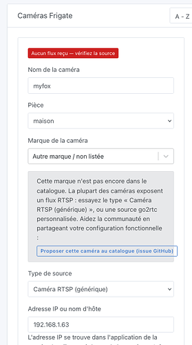

I dug out an old Myfox HD camera from a box and was able to access the RTSP streams (with a bit of tinkering and help from Claude).
I’m currently testing it.
For the first installation of Frigate, I waited, waited, waited without seeing anything except Activating containers and this for almost 5 minutes in my case.
Couldn’t we have a bit more information: Activating machin container Activating bidule container Starting configuration, etc. It helps to keep you waiting.
Besides, not knowing if it was working or not, I had a view of the containers in Portainer so I could see things progressing.
A silly question but is it better to have several MQTT servers?
Doesn’t it take too many resources?
By the way, I think the first one (linked to Gladys) should be called gladys-mqtt.
Will iGPUs be usable?
I have an i7-6700T with an Intel HD Graphics 530, and my configuration is in LXC on Proxmox.
After adding a camera, you have to restart Frigate via the button, it’s very quick to remove but when I check on the Frigate interface, you can see it working for several seconds.
Is it possible to have a message saying that it is restarting and another one saying that Frigate has restarted successfully?I have a weird thing in the frigate logs because no stream received:
2026-07-14 21:42:43.421036237  [2026-07-14 23:42:43] watchdog.myfox                 ERROR   : Ffmpeg process crashed unexpectedly for myfox.
2026-07-14 21:42:43.421510877  [2026-07-14 23:42:43] watchdog.myfox                 ERROR   : The following ffmpeg logs include the last 100 lines prior to exit.
2026-07-14 21:42:43.421817862  [2026-07-14 23:42:43] ffmpeg.myfox.detect            ERROR   : [rtsp @ 0x5df3e9281080] method DESCRIBE failed: 404 Not Found
2026-07-14 21:42:43.422323531  [2026-07-14 23:42:43] ffmpeg.myfox.detect            ERROR   : [in#0 @ 0x5df3e9280d80] Error opening input: Server returned 404 Not Found
2026-07-14 21:42:43.423726003  [2026-07-14 23:42:43] ffmpeg.myfox.detect            ERROR   : Error opening input file rtsp://127.0.0.1:8554/myfox_sub.
2026-07-14 21:42:43.423730236  [2026-07-14 23:42:43] ffmpeg.myfox.detect            ERROR   : Error opening input files: Server returned 404 Not Found
2026-07-14 21:42:43.424062999  [2026-07-14 23:42:43] watchdog.myfox                 INFO    : Restarting ffmpeg...
2026-07-14 21:42:43.427597903  [2026-07-14 23:42:43] ffmpeg.myfox.record            ERROR   : [rtsp @ 0x587306110180] method DESCRIBE failed: 404 Not Found
2026-07-14 21:42:43.429486004  [2026-07-14 23:42:43] ffmpeg.myfox.record            ERROR   : [in#0 @ 0x58730610fe80] Error opening input: Server returned 404 Not Found
2026-07-14 21:42:43.429805258  [2026-07-14 23:42:43] ffmpeg.myfox.record            ERROR   : Error opening input file rtsp://127.0.0.1:8554/myfox.
2026-07-14 21:42:43.430051951  [2026-07-14 23:42:43] ffmpeg.myfox.record            ERROR   : Error opening input files: Server returned 404 Not Found
2026-07-14 21:42:43.430383271  [2026-07-14 23:42:43] watchdog.myfox                 INFO    : Terminating the existing ffmpeg process...
2026-07-14 21:42:43.430691065  [2026-07-14 23:42:43] watchdog.myfox                 INFO    : Waiting for ffmpeg to exit gracefully...
2026-07-14 21:42:43.430965571  [2026-07-14 23:42:43] watchdog.myfox                 INFO    : FFmpeg has exited
2026-07-14 21:42:43.437221377  [2026-07-14 23:42:43] frigate.video                  ERROR   : myfox: Unable to read frames from ffmpeg process.
2026-07-14 21:42:43.437797003  [2026-07-14 23:42:43] frigate.video                  ERROR   : myfox: ffmpeg process is not running. exiting capture thread...
2026-07-14 21:42:53.431715655  [2026-07-14 23:42:53] watchdog.myfox                 ERROR   : Ffmpeg process crashed unexpectedly for myfox.
2026-07-14 21:42:53.432368812  [2026-07-14 23:42:53] watchdog.myfox                 ERROR   : The following ffmpeg logs include the last 100 lines prior to exit.
2026-07-14 21:42:53.432704330  [2026-07-14 23:42:53] ffmpeg.myfox.detect            ERROR   : [rtsp @ 0x564cdad4d080] method DESCRIBE failed: 404 Not Found
2026-07-14 21:42:53.433077687  [2026-07-14 23:42:53] ffmpeg.myfox.detect            ERROR   : [in#0 @ 0x564cdad4cd80] Error opening input: Server returned 404 Not Found
2026-07-14 21:42:53.433374886  [2026-07-14 23:42:53] ffmpeg.myfox.detect            ERROR   : Error opening input file rtsp://127.0.0.1:8554/myfox_sub.
2026-07-14 21:42:53.433696196  [2026-07-14 23:42:53] ffmpeg.myfox.detect            ERROR   : Error opening input files: Server returned 404 Not Found
2026-07-14 21:42:53.434000833  [2026-07-14 23:42:53] watchdog.myfox                 INFO    : Restarting ffmpeg...
2026-07-14 21:42:53.439373784  [2026-07-14 23:42:53] ffmpeg.myfox.record            ERROR   : [rtsp @ 0x583f9a60e180] method DESCRIBE failed: 404 Not Found
2026-07-14 21:42:53.440255376  [2026-07-14 23:42:53] ffmpeg.myfox.record            ERROR   : [in#0 @ 0x583f9a60de80] Error opening input: Server returned 404 Not Found
2026-07-14 21:42:53.440965331  [2026-07-14 23:42:53] ffmpeg.myfox.record            ERROR   : Error opening input file rtsp://127.0.0.1:8554/myfox.
2026-07-14 21:42:53.441911306  [2026-07-14 23:42:53] ffmpeg.myfox.record            ERROR   : Error opening input files: Server returned 404 Not Found
2026-07-14 21:42:53.442440790  [2026-07-14 23:42:53] watchdog.myfox                 INFO    : Terminating the existing ffmpeg process...
2026-07-14 21:42:53.442986980  [2026-07-14 23:42:53] watchdog.myfox                 INFO    : Waiting for ffmpeg to exit gracefully...
2026-07-14 21:42:53.443247330  [2026-07-14 23:42:53] watchdog.myfox                 INFO    : FFmpeg has exited
2026-07-14 21:42:53.445484742  [2026-07-14 23:42:53] frigate.video                  ERROR   : myfox: Unable to read frames from ffmpeg process.
2026-07-14 21:42:53.445978370  [2026-07-14 23:42:53] frigate.video                  ERROR   : myfox: ffmpeg process is not running. exiting capture thread...
2026-07-14 21:43:03.445628473  [2026-07-14 23:43:03] watchdog.myfox                 ERROR   : Ffmpeg process crashed unexpectedly for myfox.
2026-07-14 21:43:03.446132919  [2026-07-14 23:43:03] watchdog.myfox                 ERROR   : The following ffmpeg logs include the last 100 lines prior to exit.
2026-07-14 21:43:03.447043962  [2026-07-14 23:43:03] ffmpeg.myfox.detect            ERROR   : [rtsp @ 0x5c740b722080] method DESCRIBE failed: 404 Not Found
2026-07-14 21:43:03.447350613  [2026-07-14 23:43:03] ffmpeg.myfox.detect            ERROR   : [in#0 @ 0x5c740b721d80] Error opening input: Server returned 404 Not Found
2026-07-14 21:43:03.447811850  [2026-07-14 23:43:03] ffmpeg.myfox.detect            ERROR   : Error opening input file rtsp://127.0.0.1:8554/myfox_sub.
2026-07-14 21:43:03.448273042  [2026-07-14 23:43:03] ffmpeg.myfox.detect            ERROR   : Error opening input files: Server returned 404 Not Found
2026-07-14 21:43:03.448804734  [2026-07-14 23:43:03] watchdog.myfox                 INFO    : Restarting ffmpeg...
2026-07-14 21:43:03.452103766  [2026-07-14 23:43:03] ffmpeg.myfox.record            ERROR   : [rtsp @ 0x5cc2b3bc3180] method DESCRIBE failed: 404 Not Found
2026-07-14 21:43:03.452565866  [2026-07-14 23:43:03] ffmpeg.myfox.record            ERROR   : [in#0 @ 0x5cc2b3bc2e80] Error opening input: Server returned 404 Not Found
2026-07-14 21:43:03.453068291  [2026-07-14 23:43:03] ffmpeg.myfox.record            ERROR   : Error opening input file rtsp://127.0.0.1:8554/myfox.
2026-07-14 21:43:03.453483860  [2026-07-14 23:43:03] ffmpeg.myfox.record            ERROR   : Error opening input files: Server returned 404 Not Found
2026-07-14 21:43:03.454207492  [2026-07-14 23:43:03] watchdog.myfox                 INFO    : Terminating the existing ffmpeg process...
2026-07-14 21:43:03.454906745  [2026-07-14 23:43:03] watchdog.myfox                 INFO    : Waiting for ffmpeg to exit gracefully...
2026-07-14 21:43:03.457581480  [2026-07-14 23:43:03] watchdog.myfox                 INFO    : FFmpeg has exited
2026-07-14 21:43:03.461976405  [2026-07-14 23:43:03] frigate.video                  ERROR   : myfox: Unable to read frames from ffmpeg process.
2026-07-14 21:43:03.462400707  [2026-07-14 23:43:03] frigate.video                  ERROR   : myfox: ffmpeg process is not running. exiting capture thread...
2026-07-14 21:43:08.856999847  [2026-07-14 23:43:08] frigate.comms.dispatcher       INFO    : Turning off recordings for myfox
2026-07-14 21:43:10.709484624  [2026-07-14 23:43:10] frigate.comms.dispatcher       INFO    : Turning on recordings for myfox
2026-07-14 21:43:13.459302772  [2026-07-14 23:43:13] watchdog.myfox                 ERROR   : Ffmpeg process crashed unexpectedly for myfox.
2026-07-14 21:43:13.459729793  [2026-07-14 23:43:13] watchdog.myfox                 ERROR   : The following ffmpeg logs include the last 100 lines prior to exit
2026-07-14 21:43:13.460032195  [2026-07-14 23:43:13] ffmpeg.myfox.detect            ERROR   : [rtsp @ 0x5f0f25870080] method DESCRIBE failed: 404 Not Found
2026-07-14 21:43:13.460358529  [2026-07-14 23:43:13] ffmpeg.myfox.detect            ERROR   : [in#0 @ 0x5f0f2586fd80] Error opening input: Server returned 404 Not Found
2026-07-14 21:43:13.460667518  [2026-07-14 23:43:13] ffmpeg.myfox.detect            ERROR   : Error opening input file rtsp://127.0.0.1:8554/myfox_sub.
2026-07-14 21:43:13.460929915  [2026-07-14 23:43:13] ffmpeg.myfox.detect            ERROR   : Error opening input files: Server returned 404 Not Found
2026-07-14 21:43:13.461248905  [2026-07-14 23:43:13] watchdog.myfox                 INFO    : Restarting ffmpeg...
2026-07-14 21:43:13.465161434  [2026-07-14 23:43:13] ffmpeg.myfox.record            ERROR   : [rtsp @ 0x578c4485f180] method DESCRIBE failed: 404 Not Found
2026-07-14 21:43:13.465727570  [2026-07-14 23:43:13] ffmpeg.myfox.record            ERROR   : [in#0 @ 0x578c4485ee80] Error opening input: Server returned 404 Not Found
2026-07-14 21:43:13.466149678  [2026-07-14 23:43:13] ffmpeg.myfox.record            ERROR   : Error opening input file rtsp://127.0.0.1:8554/myfox.
2026-07-14 21:43:13.466728581  [2026-07-14 23:43:13] ffmpeg.myfox.record            ERROR   : Error opening input files: Server returned 404 Not Found
2026-07-14 21:43:13.467129440  [2026-07-14 23:43:13] watchdog.myfox                 INFO    : Terminating the existing ffmpeg process...
2026-07-14 21:43:13.467700844  [2026-07-14 23:43:13] watchdog.myfox                 INFO    : Waiting for ffmpeg to exit gracefully...
2026-07-14 21:43:13.468594620  [2026-07-14 23:43:13] watchdog.myfox                 INFO    : FFmpeg has exited
2026-07-14 21:43:13.471832732  [2026-07-14 23:43:13] frigate.video                  ERROR   : myfox: Unable to read frames from ffmpeg process.
2026-07-14 21:43:13.472497646  [2026-07-14 23:43:13] frigate.video                  ERROR   : myfox: ffmpeg process is not running. exiting capture thread...
2026-07-14 21:43:20.189883772  [2026-07-14 23:43:20] frigate.api.camera             ERROR   : Failed to fetch streams from go2rtc
2026-07-14 21:43:23.470405289  [2026-07-14 23:43:23] watchdog.myfox                 ERROR   : Ffmpeg process crashed unexpectedly for myfox.
2026-07-14 21:43:23.470737491  [2026-07-14 23:43:23] watchdog.myfox                 ERROR   : The following ffmpeg logs include the last 100 lines prior to exit.
2026-07-14 21:43:23.471086462  [2026-07-14 23:43:23] ffmpeg.myfox.detect            ERROR   : [rtsp @ 0x5a230f805080] method DESCRIBE failed: 404 Not Found
2026-07-14 21:43:23.471331927  [2026-07-14 23:43:23] ffmpeg.myfox.detect            ERROR   : [in#0 @ 0x5a230f804d80] Error opening input: Server returned 404 Not Found
2026-07-14 21:43:23.471663693  [2026-07-14 23:43:23] ffmpeg.myfox.detect            ERROR   : Error opening input file rtsp://127.0.0.1:8554/myfox_sub.
2026-07-14 21:43:23.471940651  [2026-07-14 23:43:23] ffmpeg.myfox.detect            ERROR   : Error opening input files: Server returned 404 Not Found
2026-07-14 21:43:23.472171553  [2026-07-14 23:43:23] watchdog.myfox                 INFO    : Restarting ffmpeg...
2026-07-14 21:43:23.475971145  [2026-07-14 23:43:23] ffmpeg.myfox.record            ERROR   : [rtsp @ 0x5b50c05db180] method DESCRIBE failed: 404 Not Found
2026-07-14 21:43:23.476509999  [2026-07-14 23:43:23] ffmpeg.myfox.record            ERROR   : [in#0 @ 0x5b50c05dae80] Error opening input: Server returned 404 Not Found
2026-07-14 21:43:23.477018122  [2026-07-14 23:43:23] ffmpeg.myfox.record            ERROR   : Error opening input file rtsp://127.0.0.1:8554/myfox.
2026-07-14 21:43:23.477468843  [2026-07-14 23:43:23] ffmpeg.myfox.record            ERROR   : Error opening input files: Server returned 404 Not Found
2026-07-14 21:43:23.477875002  [2026-07-14 23:43:23] watchdog.myfox                 INFO    : Terminating the existing ffmpeg process...
2026-07-14 21:43:23.478301308  [2026-07-14 23:43:23] watchdog.myfox                 INFO    : Waiting for ffmpeg to exit gracefully...
2026-07-14 21:43:23.478838076  [2026-07-14 23:43:23] watchdog.myfox                 INFO    : FFmpeg has exited
2026-07-14 21:43:23.483380449  [2026-07-14 23:43:23] frigate.video                  ERROR   : myfox: Unable to read frames from ffmpeg process.
2026-07-14 21:43:23.483380449  [LOGGING] Last message repeated 2 times
2026-07-14 21:43:23.484659189  [2026-07-14 23:43:23] frigate.video                  ERROR   : myfox: ffmpeg process is not running. exiting capture thread...
2026-07-14 21:43:33.481020152  [2026-07-14 23:43:33] watchdog.myfox                 ERROR   : Ffmpeg process crashed unexpectedly for myfox.
2026-07-14 21:43:33.481387563  [2026-07-14 23:43:33] watchdog.myfox                 ERROR   : The following ffmpeg logs include the last 100 lines prior to exit.
2026-07-14 21:43:33.481610589  [2026-07-14 23:43:33] ffmpeg.myfox.detect            ERROR   : [rtsp @ 0x5d205eacf080] method DESCRIBE failed: 404 Not Found
2026-07-14 21:43:33.481878236  [2026-07-14 23:43:33] ffmpeg.myfox.detect            ERROR   : [in#0 @ 0x5d205eaced80] Error opening input: Server returned 404 Not Found
2026-07-14 21:43:33.482090185  [2026-07-14 23:43:33] ffmpeg.myfox.detect            ERROR   : Error opening input file rtsp://127.0.0.1:8554/myfox_sub.
2026-07-14 21:43:33.482419045  [2026-07-14 23:43:33] ffmpeg.myfox.detect            ERROR   : Error opening input files: Server returned 404 Not Found
2026-07-14 21:43:33.482702233  [2026-07-14 23:43:33] watchdog.myfox                 INFO    : Restarting ffmpeg...
2026-07-14 21:43:33.486926971  [2026-07-14 23:43:33] ffmpeg.myfox.record            ERROR   : [rtsp @ 0x5f6565b85180] method DESCRIBE failed: 404 Not Found
2026-07-14 21:43:33.487488252  [2026-07-14 23:43:33] ffmpeg.myfox.record            ERROR   : [in#0 @ 0x5f6565b84e80] Error opening input: Server returned 404 Not Found
2026-07-14 21:43:33.487980415  [2026-07-14 23:43:33] ffmpeg.myfox.record            ERROR   : Error opening input file rtsp://127.0.0.1:8554/myfox.
2026-07-14 21:43:33.488438135  [2026-07-14 23:43:33] ffmpeg.myfox.record            ERROR   : Error opening input files: Server returned 404 Not Found
2026-07-14 21:43:33.488859639  [2026-07-14 23:43:33] watchdog.myfox                 INFO    : Terminating the existing ffmpeg process...
2026-07-14 21:43:33.489252009  [2026-07-14 23:43:33] watchdog.myfox                 INFO    : Waiting for ffmpeg to exit gracefully...
2026-07-14 21:43:33.489591472  [2026-07-14 23:43:33] watchdog.myfox                 INFO    : FFmpeg has exited
2026-07-14 21:43:33.494613336  [2026-07-14 23:43:33] frigate.video                  ERROR   : myfox: Unable to read frames from ffmpeg process.
2026-07-14 21:43:33.494891970  [2026-07-14 23:43:33] frigate.video                  ERROR   : myfox: ffmpeg process is not running. exiting capture thread...
It's more explicit with go2rtc:
2026-07-14 21:52:49.478393677 [INFO] Preparing new go2rtc config…
2026-07-14 21:52:49.933774211 [INFO] Starting go2rtc…
2026-07-14 21:52:50.382846133 23:52:50.382 INF go2rtc platform=linux/amd64 revision=df95ce3 version=1.9.10
2026-07-14 21:52:50.382943628 23:52:50.382 INF config path=/config/go2rtc_homekit.yml
2026-07-14 21:52:50.383533609 23:52:50.383 INF [rtsp] listen addr=:8554
2026-07-14 21:52:50.383725377 23:52:50.383 INF [api] listen addr=:1984
2026-07-14 21:52:50.384027776 23:52:50.384 INF [webrtc] listen addr=:8555
2026-07-14 21:52:56.715912143 23:52:56.715 WRN [rtsp] error=« streams: dial tcp 192.168.1.63:554: connect: connection refused » stream=myfox_sub
2026-07-14 21:52:56.746682658 23:52:56.746 WRN [rtsp] error=« streams: dial tcp 192.168.1.63:554: connect: connection refused » stream=myfox_sub
2026-07-14 21:52:58.246229812 23:52:58.244 WRN [rtsp] error=« streams: dial tcp 192.168.1.63:554: connect: connection refused » stream=myfox_sub
2026-07-14 21:52:58.252579037 23:52:58.251 WRN [rtsp] error=« streams: dial tcp 192.168.1.63:554: connect: connection refused » stream=myfox
2026-07-14 21:52:58.470033836 [INFO] Starting go2rtc healthcheck service…
2026-07-14 21:53:18.244258503 23:53:18.244 WRN [rtsp] error=« streams: dial tcp 192.168.1.63:554: connect: connection refused » stream=myfox_sub
2026-07-14 21:53:18.252711056 23:53:18.252 WRN [rtsp] error=« streams: dial tcp 192.168.1.63:554: connect: connection refused » stream=myfox
2026-07-14 21:53:28.257319855 23:53:28.257 WRN [rtsp] error=« streams: dial tcp 192.168.1.63:554: connect: connection refused » stream=myfox_sub
2026-07-14 21:53:28.264956895 23:53:28.264 WRN [rtsp] error=« streams: dial tcp 192.168.1.63:554: connect: connection refused » stream=myfox
2026-07-14 21:53:38.280052154 23:53:38.279 WRN [rtsp] error=« streams: dial tcp 192.168.1.63:554: connect: connection refused » stream=myfox_sub
2026-07-14 21:53:38.294744579 23:53:38.294 WRN [rtsp] error=« streams: dial tcp 192.168.1.63:554: connect: connection refused » stream=myfox
I'm going to fiddle with the camera again because the stream doesn't seem to be accessible.
Hi @GBoulvin !
No worries, your test ultimately came back « normal », but it did reveal a flaw that we can fix — and that’s exactly what these tests are for, so thank you so much! :pray:
The explanation: your test container is called gladys-frigate… which was precisely the name that the integration gave to its Frigate container. On first startup, the update routine looked for « its » container by that name, found yours, and replaced it — hence the self-deletion (your logs stop abruptly right after update #1 of the container required...). This is really related to the test setup: in a normal installation, the Gladys container is called gladys, and no one names a manually installed container « gladys-frigate ». But the flaw was real, and it’s fixed in the updated image:
  • the integration containers are now called gladys-frigate-server / gladys-frigate-mqtt;
  • the name is verified before use (automatic fallback to a suffixed name if it’s already taken), then remembered;
  • and most importantly, an existing container is only « recognized » if its image proves it’s ours.
Your Gladys container will therefore never be looked at again, even if it keeps its current name. :+1:
If you could try again with the fresh image (your same docker run command works as is), it should work.
Quick question by the way: what was exactly left in /var/lib/gladysassistant-frigate after the incident? A docker rm normally doesn’t empty a mounted folder, so I want to check if it was a side effect of the restarts or a second issue to investigate.
EDIT: And on the other hand, this would reveal an identical bug for the Zigbee2mqtt, Node-red, and Matterbridge containers according to Claude … :face_with_peeking_eye: :scream:
