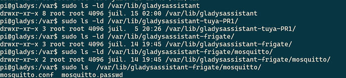

Well, it seems something went wrong, probably on my end. Indeed, even when the container is running, the db is not stored there. And similarly in the other test folder (tuya), I only have the mosquitto folder.
So, to answer the question, the mosquitto folder remains, but that’s what was there before…
As for permissions, they seem fine too…

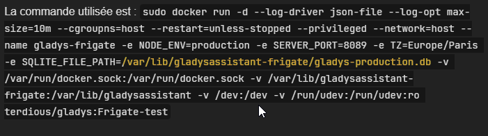

Hi! I just restarted a test, without success… Actions taken: installation, account creation, activation of the frigate integration and error: Frigate installation failed. Gladys’s log: 2026-07-16T20:42:27+0200 <info> detectHardware.js:78 (FrigateManager.detectHardware) Frigate: no compatible render node found, video decoding on CPU 2026-07-16T20:42:27+0200 <info> allocatePorts.js:33 (FrigateManager.allocatePorts) Frigate: allocated port 1885 for MQTT broker 2026-07-16T20:42:27+0200 <info> allocatePorts.js:33 (FrigateManager.allocatePorts) Frigate: allocated port 8971 for Frigate UI 2026-07-16T20:42:27+0200 <info> allocatePorts.js:33 (FrigateManager.allocatePorts) Frigate: allocated port 5000 for Frigate API 2026-07-16T20:42:27+0200 <info> allocatePorts.js:33 (FrigateManager.allocatePorts) Frigate: allocated port 8554 for Frigate RTSP restream 2026-07-16T20:42:27+0200 <info> allocateContainerNames.js:54 (FrigateManager.allocateContainerNames) Frigate: allocated container name gladys-frigate -mqtt for the MQTT broker 2026-07-16T20:42:27+0200 <info> allocateContainerNames.js:63 (FrigateManager.allocateContainerNames) Frigate: allocated container name gladys-frigate -server for Frigate 2026-07-16T20:42:27+0200 <info> checkForContainerUpdates.js:14 (FrigateManager.checkForContainerUpdates) Checking for current installed versions and required updates... 2026-07-16T20:42:27+0200 <info> checkForContainerUpdates.js:18 (FrigateManager.checkForContainerUpdates) Frigate MQTT container: update #1 of the container required... 2026-07-16T20:42:27+0200 <info> checkForContainerUpdates.js:32 (FrigateManager.checkForContainerUpdates) Frigate MQTT container: update #1 of the container done 2026-07-16T20:42:27+0200 <info> checkForContainerUpdates.js:37 (FrigateManager.checkForContainerUpdates) Frigate container: update #1 of the container required... 2026-07-16T20:42:27+0200 <info> checkForContainerUpdates.js:51 (FrigateManager.checkForContainerUpdates) Frigate container: update #1 of the container done 2026-07-16T20:42:27+0200 <info> installMqttContainer.js:26 (FrigateManager.installMqttContainer) Frigate MQTT broker is being installed as Docker container... 2026-07-16T20:42:27+0200 <info> installMqttContainer.js:27 (FrigateManager.installMqttContainer) Pulling eclipse-mosquitto:2.0.15 image... 2026-07-16T20:42:27+0200 <info> installMqttContainer.js:31 (FrigateManager.installMqttContainer) Preparing Frigate broker environment... 2026-07-16T20:42:27+0200 <info> installMqttContainer.js:40 (FrigateManager.installMqttContainer) Writing Mosquitto config file in /var/lib/gladysassistantfrigate/frigate/mqtt/mosquitto.conf 2026-07-16T20:42:28+0200 <info> installMqttContainer.js:57 (FrigateManager.installMqttContainer) Creating container with data in "/var/lib/gladysassistant" on host... 2026-07-16T20:42:28+0200 <info> installMqttContainer.js:70 (FrigateManager.installMqttContainer) Frigate MQTT broker is restarting... 2026-07-16T20:42:33+0200 <info> installMqttContainer.js:78 (FrigateManager.installMqttContainer) Creating user/pass... 2026-07-16T20:42:33+0200 <error> installMqttContainer.js:97 (FrigateManager.installMqttContainer) Frigate MQTT broker container failed to start: Error: (HTTP code 409) container stopped/paused - Container 097cd7cedd297728a2687b09135c89e59e7f7938854f7b31914d19e6174eb21b is restarting, wait until the container is running at /src/server/node_modules/docker-modem/lib/modem.js:336:17 at getCause (/src/server/node_modules/docker-modem/lib/modem.js:366:7) at Modem.buildPayload (/src/server/node_modules/docker-modem/lib/modem.js:335:5) at IncomingMessage.<anonymous> (/src/server/node_modules/docker-modem/lib/modem.js:303:16) at IncomingMessage.emit (node:events:531:35) at endReadableNT (node:internal/streams/readable:1698:12) at processTicksAndRejections (node:internal/process/task_queues:89:21) { reason: 'container stopped/paused', statusCode: 409, json: { message: 'Container 097cd7cedd297728a2687b09135c89e59e7f7938854f7b31914d19e6174eb21b is restarting, wait until the container is running' } } 2026-07-16T20:42:33+0200 <warn> errorMiddleware.js:68 (errorMiddleware) Error: (HTTP code 409) container stopped/paused - Container 097cd7cedd297728a2687b09135c89e59e7f7938854f7b31914d19e6174eb21b is restarting, wait until the container is running at /src/server/node_modules/docker-modem/lib/modem.js:336:17 at getCause (/src/server/node_modules/docker-modem/lib/modem.js:366:7) at Modem.buildPayload (/src/server/node_modules/docker-modem/lib/modem.js:335:5) at IncomingMessage.<anonymous> (/src/server/node_modules/docker-modem/lib/modem.js:303:16) at IncomingMessage.emit (node:events:531:35) at endReadableNT (node:internal/streams/readable:1698:12) at processTicksAndRejections (node:internal/process/task_queues:89:21) { reason: 'container stopped/paused', statusCode: 409, json: { message: 'Container 097cd7cedd297728a2687b09135c89e59e7f7938854f7b31914d19e6174eb21b is restarting, wait until the container is running' } } And what I suspect is the reason, the log of the mqtt service: 1784227505: Error: Unable to open config file /mosquitto/config/mosquitto.conf. Because the .conf file is in /mosquitto/mosquitto.conf… Here is its content: sudo nano /var/lib/gladysassistantfrigate/mosquitto/mosquitto.conf allow_anonymous false connection_messages false password_file /mosquitto/config/mosquitto.passwd listener 1883 And the same, the mosquitto.passwd is not in a config folder… And the mystery remains, no DB file :distorted_face:
Hi @GBoulvin,
Didn’t you make a mistake here:
In yellow, it’s the path in the container that is needed… so normally /var/lib/gladysassistant/gladys-production.db
In my case:

Ahhhhh, if that’s the path in the container, then, yeah, that’s not fair!
It’s all better now! :rofl:

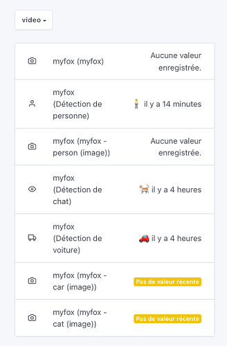

There you go, I managed to switch the myfox to trendnet (but not 100% as there is still a piece of myfox left) and I can have analyses with frigate.
However, I don’t have a 100% operational stream but it works for detection.
I still have a question about the dashboard info: what should I have in image:
However, it detected a cat and a car in the house while I have neither.
:grimacing:
