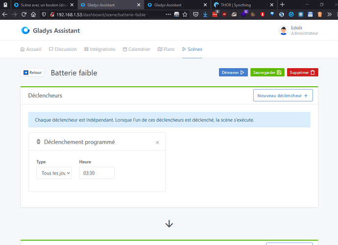

What do these scenes do? :slight_smile:
If you have complete screenshots of the page with the entire scenario, that would be even better :grinning_face_with_smiling_eyes:
I understand! I agree that we could improve the current process, I’m trying to gather feedback so we can think about the need and see how to do better
Here you go (beware, it’s loooooong) :slight_smile:
As you can see, it’s a bit long and repetitive to do. There’s also a lot of room for error!
