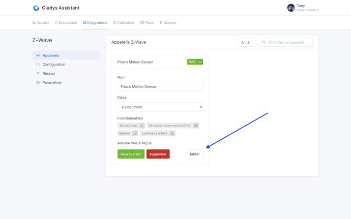

I was thinking about the question, where I agree that we want to make the « plugged-in lamp » case possible, I’m not sure if we want the user to be able to modify the entire configuration of these services that are supposed to be plug-and-play.
We really need to expose only the vital minimum to the end user.
We agree that we want to add an « Edit » button to the Philips Hue integration, in this style:

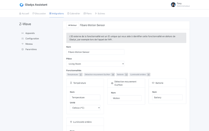

Then, this button displays a view of this style:
On this view, I think we only want to allow the modification of the category if it’s a plug that we want to turn into a light.
For example, we could have a true/false toggle « this plug is a lamp, allow Gladys to control this plug as a lamp », which would switch the category from switch to light and vice versa.
What do you think?
@pierre-gilles, for me, this would already be perfect from this point of view and more than sufficient. Simple and effective = Gladys v4 ^^
