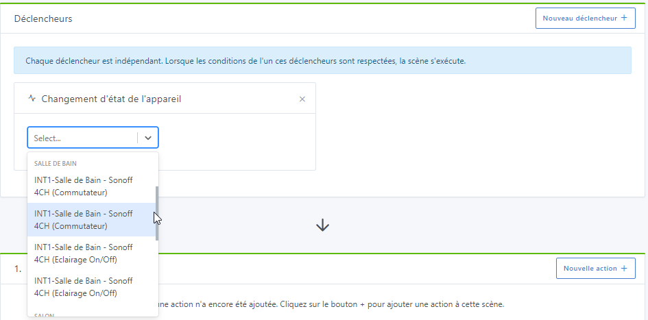

Some of you have complained about not being able to differentiate certain devices from others in Gladys’ select boxes. (@Terdious, @Romuald_Pochet)
I noted this case for example:
It’s true that for some integrations (Z-Wave, Zigbee, MQTT, and Sonoff), there can sometimes be several features of the same type on the same device, and as a result, it’s not very readable at the moment!

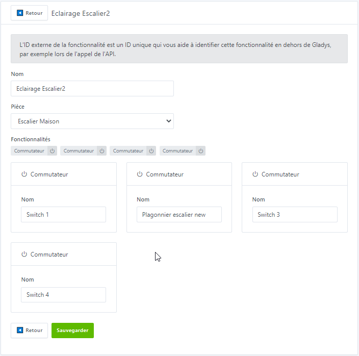

But this complicates things. Why, for integrations like Philips Hue, not put in the DB in the « name » field the category of the feature if that’s the case? In fact, for any integration AMHA, we always want to display the name of the feature. If we can’t change the name of the Philips Hue feature, it doesn’t matter, it’s done in the code and in this case, we can give it the name of the category and type if we want. And this avoids having to make specific cases while keeping it simple, right?
It also reminds me that… why can’t we modify this name anyway? We agree that on the Dev side, this name is never used (and thankfully). It would simplify many things.

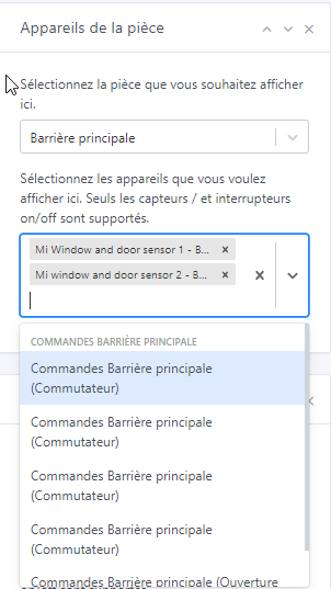

I confirm that on the dashboard we do retrieve the name, but for the edit page in the selection it is not the case either for MQTT. It appears as Zigbee2Mqtt and Tasmota:
The 4 switches above are named « Opening […] », « Closing […] », etc.

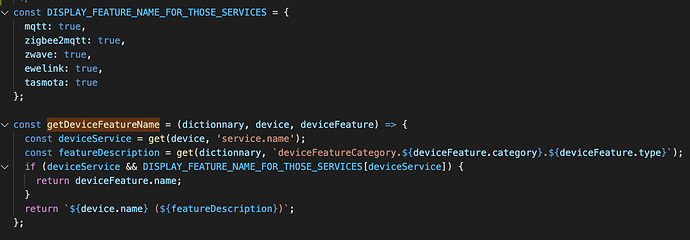

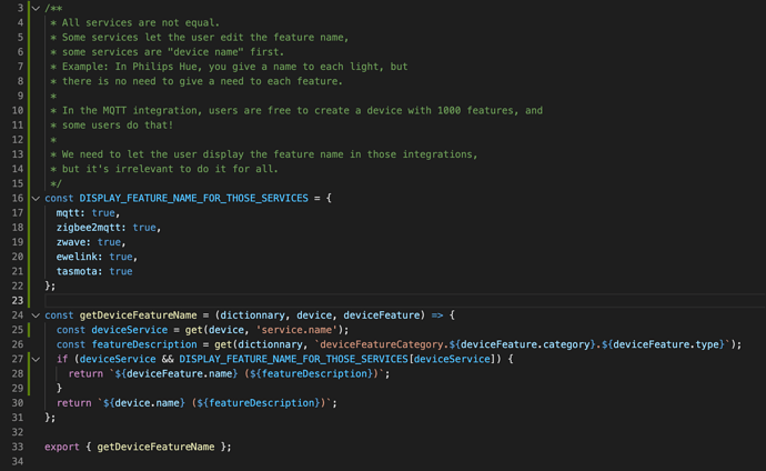

const getDeviceFeatureName = (dictionary, device, deviceFeature) => {
  const deviceService = get(device, 'service.name');
  const featureDescription = get(dictionary, `deviceFeatureCategory.${deviceFeature.category}.${deviceFeature.type}`);
  if (deviceService && DISPLAY_FEATURE_NAME_FOR_THOSE_SERVICES[deviceService]) {
    return `${device.name} (${deviceFeature.name})`;
  return `${device.name} (${featureDescription})`;

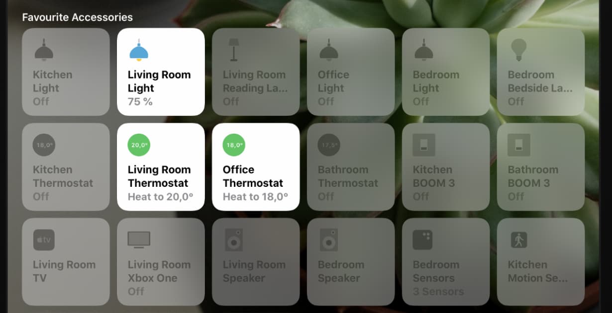

Apple Homekit
Each device has a name (equivalent to deviceName), and it is this name that is displayed.
There is no notion of deviceFeature, at least it is not exposed to the public, it only sees a device with « capabilities » that are not named:
