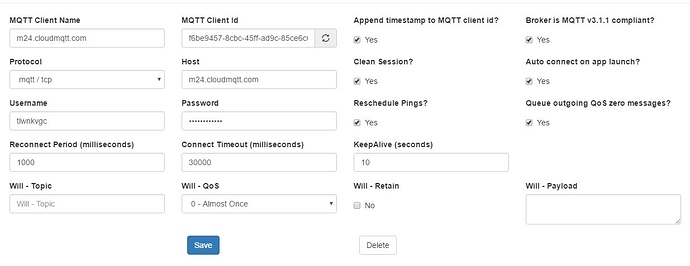

Can you explain how to configure MQTTBox?
Ok, based on what I’ve done:
  • MQTT Client Name: the client name (ex: Gladys)
  • MQTT Client id: leave as is
  • Protocol: mqtt or mqtts (if secure)
  • Host: the URL of your MQTT broker (ex: 192.168.1.40:1883)
  • Username: the login if needed
  • Password: the password if needed
I left everything else with the default values.

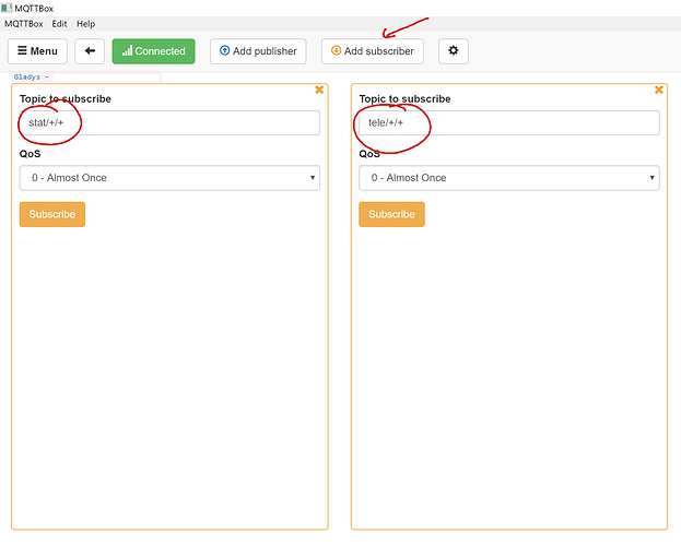

Once created, you will arrive on a page where you will need to add 2 subscribers:
  • stat/+/+
  • tele/+/+
If you put « +/+ », you will see messages from all devices.
If you want to filter on your device only, replace the first « + » with the « topic » of the device, the one you specified on the device configuration page.
For example:
  • stat/sonoff-plug/+
  • tele/sonoff-plug/+
