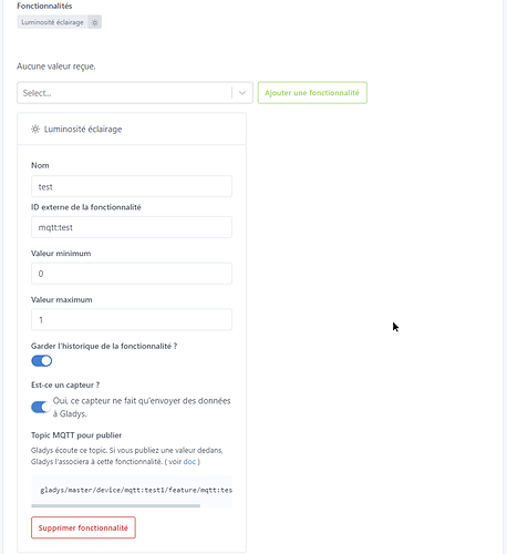

Hello !!
Well, the first PR for Keep History is almost ready according to what we discussed yesterday. Simple… or almost ^^
One point to check though, I made the change for integrations where editing devices is supported as well as for mqtt which is independent. However some integrations (like Philips Hue) are not editable. Should I take the opportunity to add this edit page for the missing integrations?
Otherwise it looks like this for mqtt:
Perfect!
It’s just the label that’s not very explicit I think,
