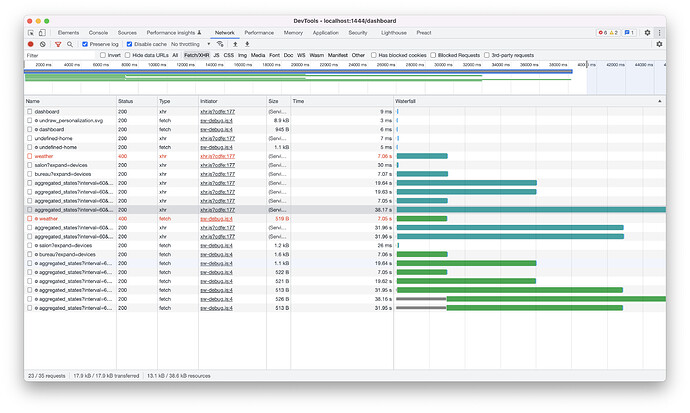

First, the issue was very clear: it was super slow even on my fairly powerful development machine, I don’t know how you manage to cope with that, it was ultra slow ^^
To illustrate, I saw this:
Almost 40 seconds to display the page, that’s just huge ^^

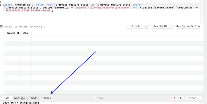

I ran Gladys locally in debug mode to see the executed SQL queries and I ran them manually on the DB, « live Â».
6 seconds for a query that returns nothing, that’s a lot!
So I pulled the thread, there are 2 conditions on this query (WHERE device_feature_id = ? AND created_at >= ?), and both of these attributes do have an index
I run EXPLAIN QUERY PLAN to understand what SQLite is doing, and I understand.
SQLite could use the index on device_feature_id to fetch all states for that feature, but then it did a sequential scan to filter by date: the index on the date wasn’t used.
The solution is very simple: just add an index that covers the 2 attributes used in the query.
So I added 2 indexes on device_feature_state and t_device_feature_state_aggregate covering the attributes used by the dashboard queries.
await queryInterface.addIndex('t_device_feature_state', ['device_feature_id', 'created_at']);
await queryInterface.addIndex('t_device_feature_state_aggregate', ['device_feature_id', 'type', 'created_at']);
And then: bam! That same query goes from 6 seconds to
 5ms!! :grimacing:
For the whole page, it goes from 40 seconds to.. 100 ms on my machine!

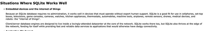

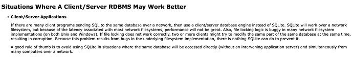

In our use case (embedded program), SQLite is the most suitable, that’s why I defend it :smiley: Client/server DBMSs (MySQL/PostgreSQL) are suitable when you have a database server that is accessed by multiple clients over a network.
I quote the SQLite website: Appropriate Uses For SQLite

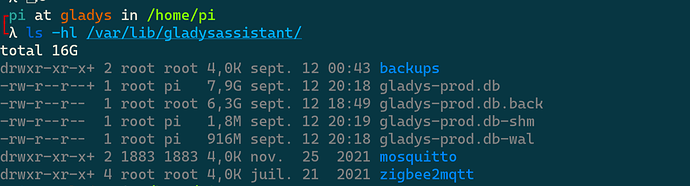

Great! Yes, it’s normal for the migration to take some time; you have to build the entire index.
Your database will also be larger, easily +20% typically, but that’s the price to pay for it to display instantly! :grinning_face_with_smiling_eyes:
Oh yes, from 6.3GB to 7.9GB :scream:
