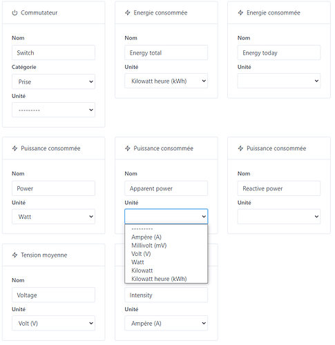

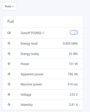

No no you’re not nitpicking ^^ That’s right and it’s « important » to distinguish for an electrician ^^, but I think the docs aren’t correct because on the interface we do see VA and VAr :
So, we agree that dividing by 1000 shouldn’t happen; in that case the user will just have to change the unit to millivolts which is available in the editor?
Totally, it would have been better to return the module model as is done with the DHT11 for example, to disambiguate in cases like this.
Do you think I can open the PR (pull request) like this?
I don’t see any reason to do it

  • On the front end there’s a change to make for displaying the reactive power unit, which is in lowercase instead of uppercase.
  • Also, in the feature editing, the energy units in Wh and the power units VA and VAr are not displayed.
Can I do them in the same PR or is it better to do them separately?
Because you’re in the switch category and not the energy sensor.
I’m not really sure whether we should add all the units to the switches or remove them — I’m afraid it would be redundant.
Indeed!! We can rather move these Tasmota features into « Energy », indeed. They are quite specific and categorized as « Energy » on tasmota. The switch itself is indeed separate!!^^

  • Fix of the voltage which was divided by 1000 resulting in mV for the POW R2 (with unit in Volt). If on other devices the voltage is reported in millivolts then the user will have to select the correct unit in the device edit menu.
  • Fix of the category and type of the energy feature to ENERGY_SENSOR rather than SWITCH in order to obtain the correct units in the device/function edit menu.

On my side, everything I was able to test works as far as Tasmota is concerned.
MQTT discovery OK
HTTP discovery OK
Switches, temperatures, humidity OK
The rest of the instance seems to be working without issues.
