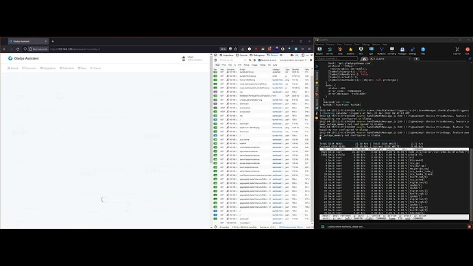

I’ve been feeling this for a while, but I was able to confirm it now by recording my screen.
Starting Gladys
If the Gladys container is stopped and then started again (after an update for example), the first loading of the graphs takes a lot of time.
This is certainly partly due to the size of the DB 4.5Go! But not only, since you explained that you only take a very small part of the data to speed up the display.
Demo video (1m30)
Note:
  1. The Gladys page is open at the beginning, but do not take it into account
  2. I (re) launch Gladys, then I refresh the gladys web page
  3. This is where we see the slowness and the high use of the « disk » (SD card at my place)
Interesting @lmilcent, thanks for the feedback with the video :slight_smile:
First, I see that all your graphs are « last hours » displays, and that’s LIVE data (not aggregated), so it’s possible that there are thousands of lines/hundreds of thousands depending on whether your sensors are verbose or not.

@lmilcent DB fix deployed!
I noticed that Gladys worked for a very long time, so I infer that it cleaned the data, although I haven’t checked yet.
I manually ran a VACUUM which freed up 100 MB.
Great :slight_smile: We’ll see how it looks at the next save
