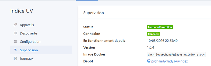

For TV integration, this isn’t possible. When the TV is on, we’ll have the info that we’re connected. But once turned off, we risk having false notifications.
I’m talking about this:
When the TV is off, does « Connection » switch to disconnected on your end?
Yes :slight_smile: because the websocket is closed
Let’s see if we can add some exclusions :wink:

But I was just giving this as an example, it may be in a disconnected state because Daikin is experiencing a problem, for example, or the integration encountered an unhandled error and it crashed and ended up in a disconnected state
What are the connection statuses? Connected, disconnected? Maybe we should have a degraded state?
No idea :sweat_smile:
Yeah maybe a degraded state would be nice

Good news: for external integrations, most of the monitoring already exists on the server side. Each integration sends a heartbeat to Gladys, a health check runs continuously, and the integration goes into a degraded state when it loses its connection to the third-party service or stops responding, with automatic restart and backoff behind the scenes.
The « degraded » state that you proposed @spenceur already exists internally :+1: What’s missing is the user-facing part: being notified.
