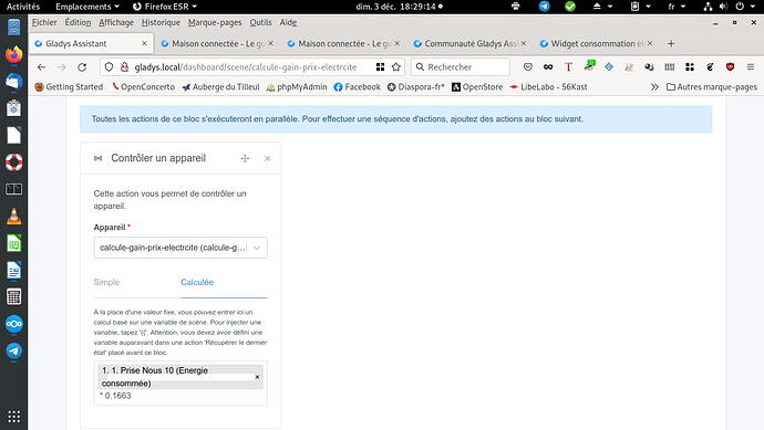

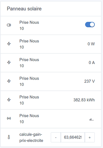

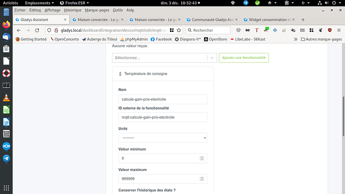

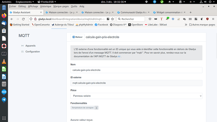

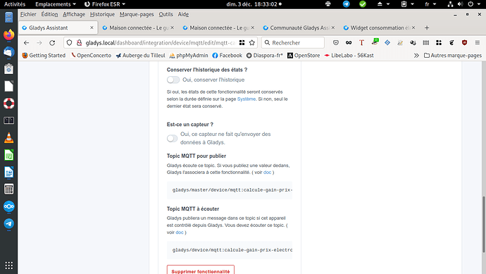

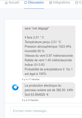

I did this (based on the lowest price)
For my solar panel, production since it was commissioned.
