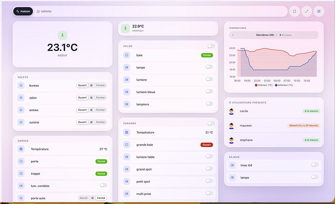

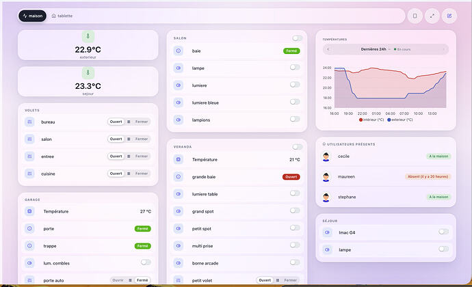

That said, Iâm having a slight issue with the temperature widget:
Hereâs a preview while editing:
and the result on the dashboard once validated:
I donât think this is the normal behavior, is it?

I donât know if this is normal or not, but if this widget takes up too much vertical space, thatâs what you get.
I would suggest that the result be almost the same as in the edit, but with vertical centering. Letâs see what that looks like.
Actually, there isnât much space, thereâs even a vertical elevator â thatâs exactly what surprises me:
Thanks for the feedback, Iâll check it out
if this can help, it seems to be an issue only on the first column because when moving one of the 2 temperatures to the right column, it displays correctly and the second one becomes even more distorted:

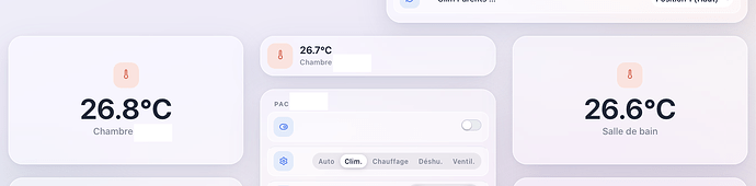

Indeed, it seems to be on the first and last for me:
