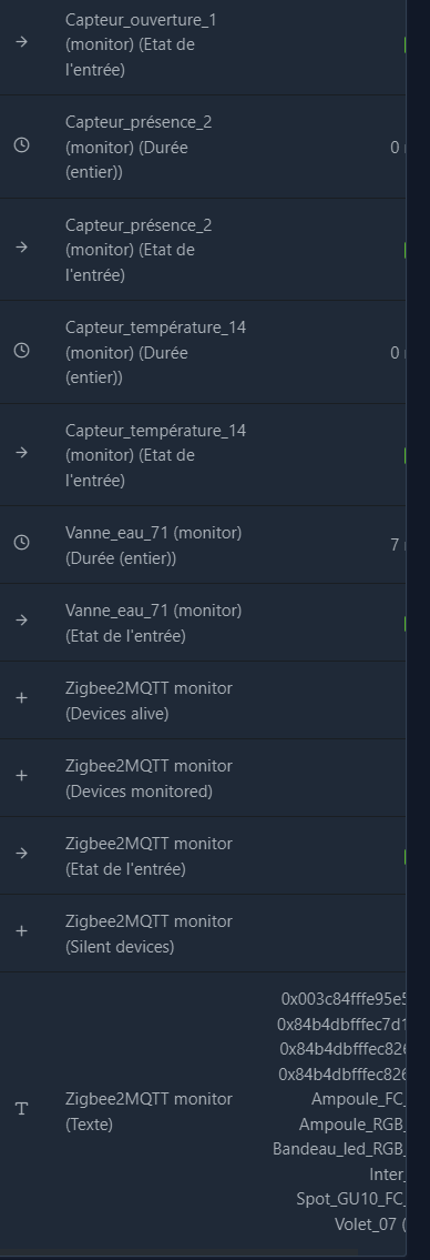

@prohand I have a display issue with the data:
The display is managed by the core

@Chris75 Are you in the same case with 3 columns?
And are you sure you’re on the latest version of Gladys? (4.86.1)
yes I am on 3 columns and indeed on 4.86.1

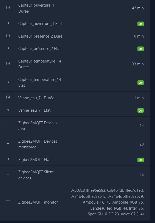

but if I switch to 2 columns I do have the data
@Chris75 I can’t reproduce the issue on my end
Have you tried in private browsing and clearing the cache?
yes and it’s still the same (I’m on Firefox Windows 11)
If you remove that one, do you still have the problem?
yes indeed the problem disappears and everything else displays correctly
Thanks for the feedback :slight_smile:
I created an issue: Long text value breaks device widget in a 3-column dashboard layout · Issue #2917 · GladysAssistant/Gladys · GitHub
