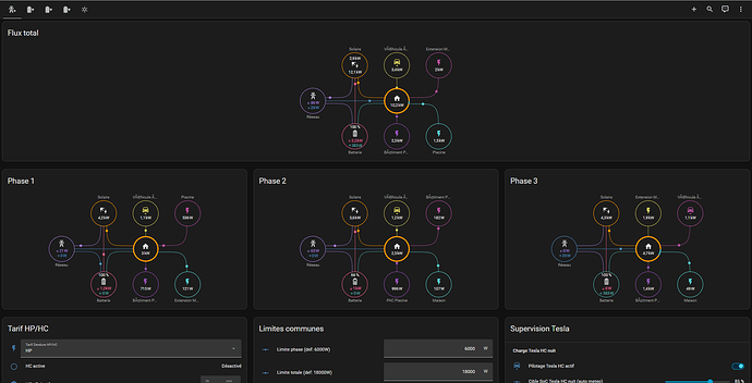

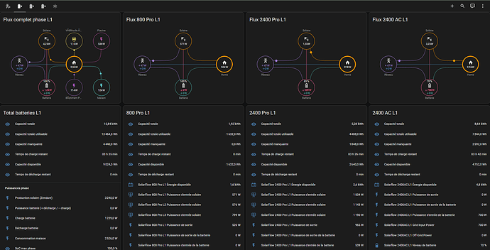

A flow view per phase. The « Total Flow » dashboard shows, in real time, the distribution of solar / batteries / loads (Tesla, swimming pool, heat pump, professional building, extension, house) on each of the 3 phases:

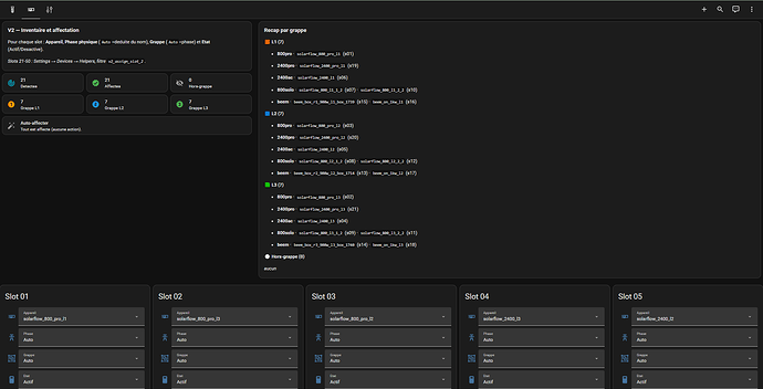

21 controlled devices, 7 per phase. Each phase groups its Zendure SolarFlow (800 Pro / 2400 Pro / 2400 AC / 800 solo) and its Beem, managed as a « cluster »:

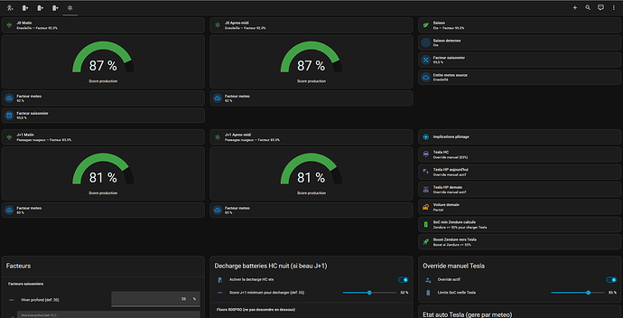

Weather-driven control. The engine calculates a production score (J0 morning/afternoon, J+1) from the forecasts, and makes concrete decisions: discharge or not the batteries during off-peak hours at night if the next day looks sunny, when to charge the Tesla (off-peak/peak), boost the Zendure → Tesla transfer, etc.:

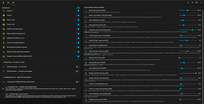

Behind the scenes, this engine also manages cross-phase balancing, hierarchical PV curtailment and load/discharge distribution per device, with a dryrun → live mode to test without risk. I deliberately kept most of these « engine » views out of the post to avoid overwhelming everyone — I’ll go into detail in response if interested.

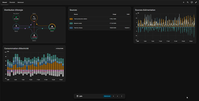

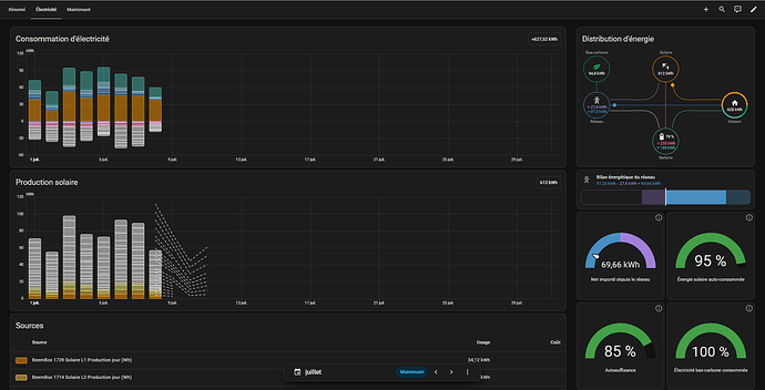

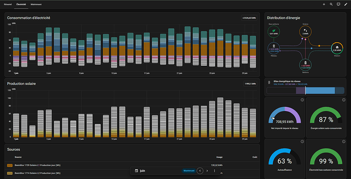

And the monthly balance, via the official HA energy dashboard. Network / solar / battery / house distribution, self-consumption, self-sufficiency, low-carbon share:
In June: solar production ~2 MWh, 87% self-consumption, 63% self-sufficiency, 99% low-carbon, net network import 708.95 kWh → €159.05.
And July then? The summer peak is here ^^ And the months of July / August seem to be off to a good start — 95% / 85% / 100%. I finished my installation + automations on June 25, 2026 so we still have beautiful days ahead of us ^^ And 9 panels left to install ^^

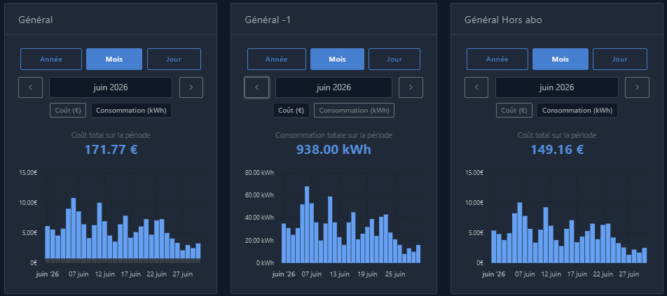

This is the heart of my experience on the « bill » side. The « Total Cost Tracking » dashboard puts side by side:
  • General → the real EDF cost (Shelly at the TGBT)
  • Total actual consumption → the sum of the 7 panels (i.e. everything that is actually consumed by the buildings)
June: General = €171.77 / 938 kWh · Total actual consumption = €438.03 / 2,277 kWh. The difference speaks for itself: on paper my consumption « would cost » ~€438, but I only paid ~€172 to EDF — the rest is covered by self-production.

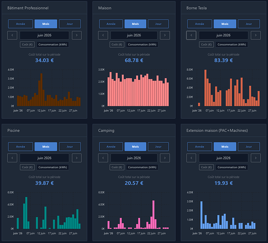

And where Gladys really makes a difference for me: the detail per zone. Each building/usage has its own real cost card, which allows you to immediately see where the energy (and money) is going.
In June, for example: Personal building ~€171, Tesla charger ~€83, House ~€69, Swimming pool ~€40, Professional building ~€34, Campsite ~€21, PAC+Machines extension ~€20… You can then go down to the level of a specific usage — for example the Renault Spring charger, where you can clearly see the rhythm of the recharges:

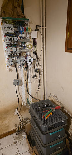

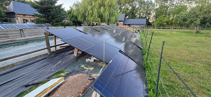

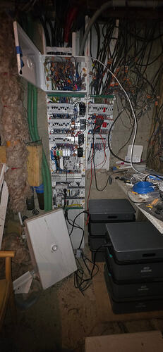

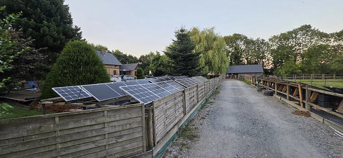

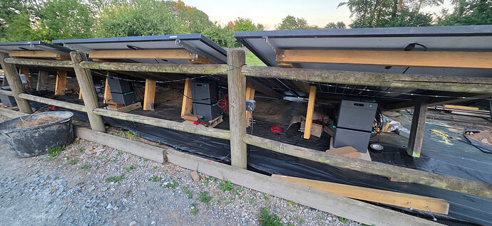

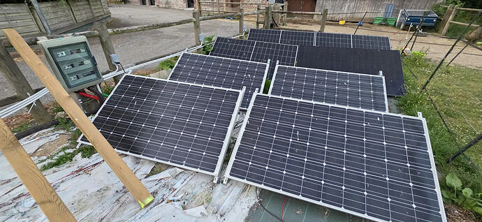

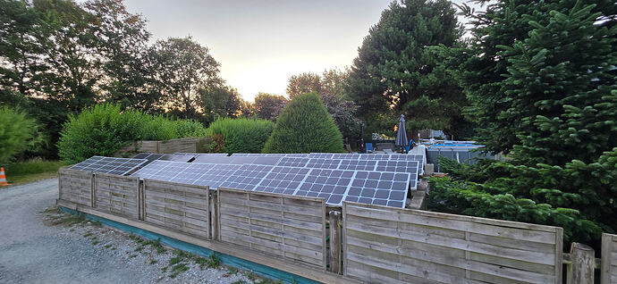

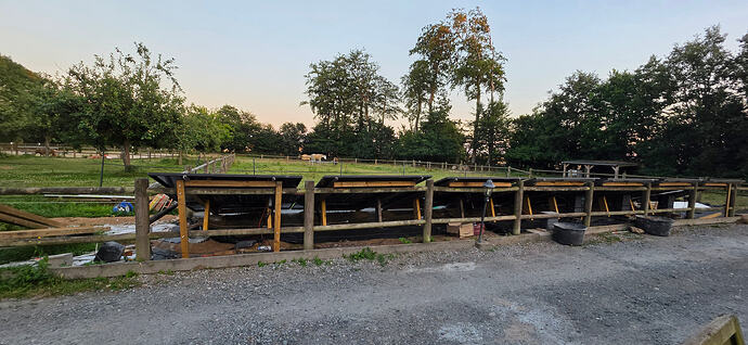

And since you mentioned the installation, here are a few photos to give an idea. The ground structure below represents only half of the planned field: the second half, identical, will come in its continuity. So, it will be 14 structures of 3 Zendure panels + 2 structures of 3 Beem panels + an old installation of 3×3 Beem 300W kits.
Sorry about the state of the panels… finishing touches in progress ^^
Note that:
  • The total solar material investment is €25,000
  • The structures and electrical material investment is €6,000
  • The pessimistic savings target is €4,000/year, the optimistic savings target is €6,500/year
  • The targeted return on investment is 5 years for the solar material and 6 years for the total investment.
