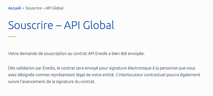

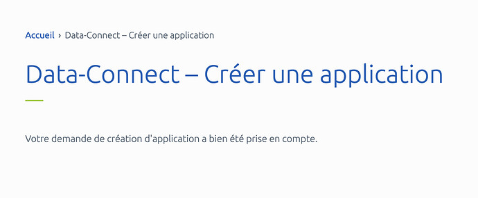

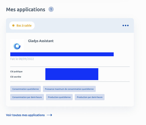

Well, it’s moving very quickly, I’ve already received a response from Enedis, they need additional information but I already have a first version of the API contract ![]()
On my side I’ve tested the API in the sandbox, and I’ve started implementing routes on the Gladys Plus side to handle authentication (that was quick)

@bertrandda I have a first version of the API ready for you!
I’ve sent you all the information to use the API in a DM ![]()
Don’t hesitate to reply there if you have any questions!

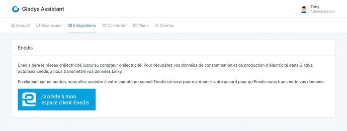

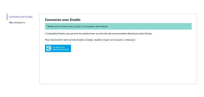

Connection with the Enedis API

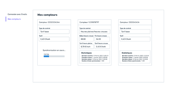

Display of the different detected meters, and contract/tariff declaration

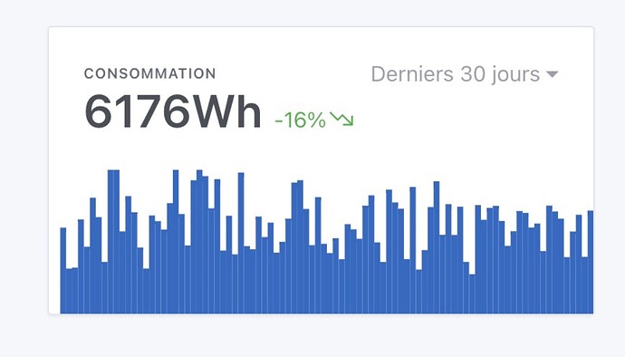

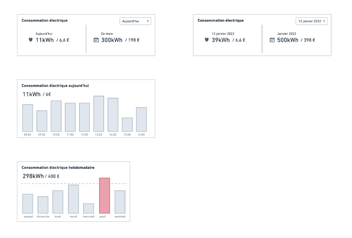

Dashboard display
I think it’s interesting to have boxes on the dashboard dedicated to electricity consumption so we can allow extensive customization on this topic.
I’m specifically thinking about calculating the cost of consumed electricity, computed from the data provided by the meters:
What do you think of this idea?
Is there any information missing?
