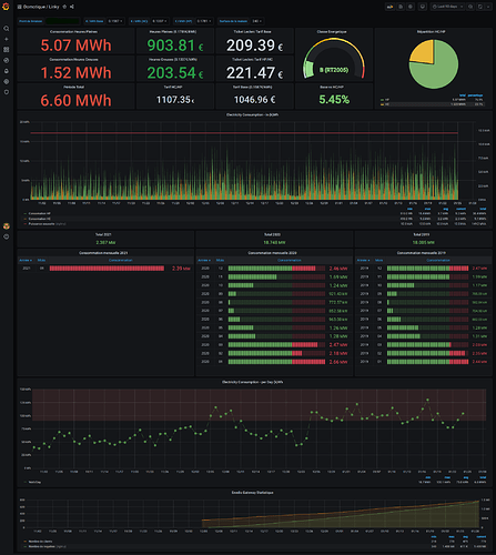

Well, personally I don’t use the HA integration, I made a NodeRED flow that sends everything directly to my Influxdb + MQTT.
I then have a Grafana dashboard that queries the InfluxDB to get a good view of the history with graphs & co:
The historical/graphical mode of HA is very limited compared to a Grafana or other…

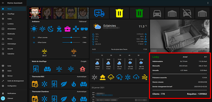

Just one HA card in Markdown mode that retrieves info via MQTT:
PS: Sorry for the double post, but I can only share one screenshot as I’m new to the forum.
Your Grafana makes you dream :smiley:

That’s clear, your Grafana is magnificent! :slight_smile:
I’ll keep it in mind to imagine the next box dashboards on Gladys!
