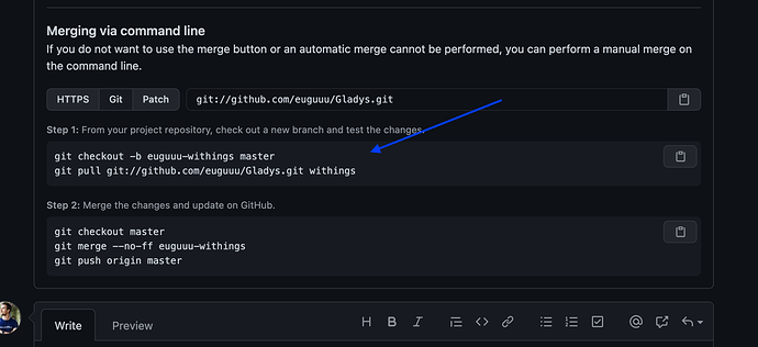

When I review a PR, I pull the PR branch by following the commands provided by GitHub:
Then, I start the server:

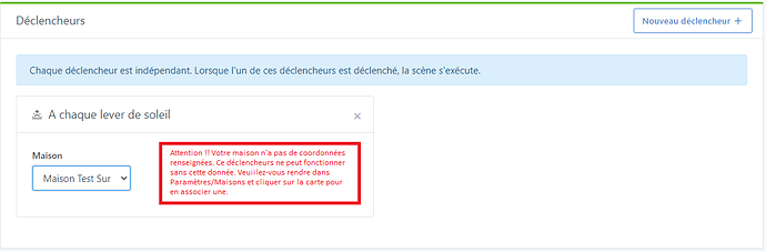

Scenes are created for testing. Now we just have to wait.
However, I already have a comment. It is not specified anywhere what needs to be configured in advance to benefit from this scene. Maybe if the house coordinates (I assume that’s the only condition) are not provided, a warning message would be welcome in the trigger box - especially since there is room:
@pierre-gilles:

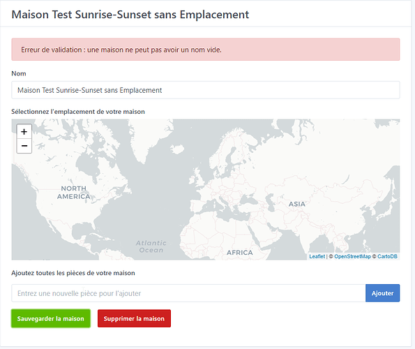

When testing a long house name, I was able to identify a « bug Â». When you enter a long name, here â€č Maison Test Sunrise-Sunset sans Emplacement â€ș, the UI returns an error that is not appropriate when saving:
instead of « Validation error: Your home name is too long Â».
Issue only in FR.
Issue #1055 created. I will try to do the PR as soon as possible.

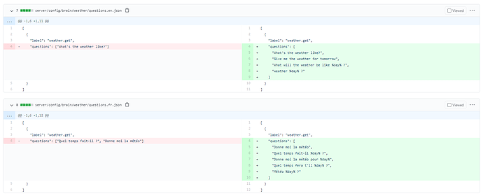

For the testing part, I took this as a basis:
Plus the whole response part. So indeed, I couldn’t test everything because I don’t have snow forecast. But for the rest, everything was functional for all the days of the week, tomorrow and the day after tomorrow; and for all types of questions I did the tests with and without accent, with extra spaces between two, with small typos (ex.: « Donn moi la meteo Â» or « Donne le meteo Â») and all the returns were as expected. For the part I couldn’t test (the snow), I read the code to see if it was like the rest tested. I didn’t see anything in particular.
Let me know especially if my methodology is not the right one, or if there are additional things I should get used to doing more. If I can help more by doing it right, it will be a pleasure.
That’s good news, the update must have done a lot. (Accents, typos,
I made sure the questions were the same for everyone, so if it works for rain, it will work for snow.

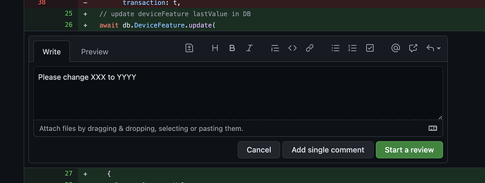

This is not pollution, on the contrary. Everything related to PR reviews should be in GitHub; it’s much easier for the developer to take your feedback one by one and address them.
When you do a review, start a review, and leave comments in the code where you think there are issues:

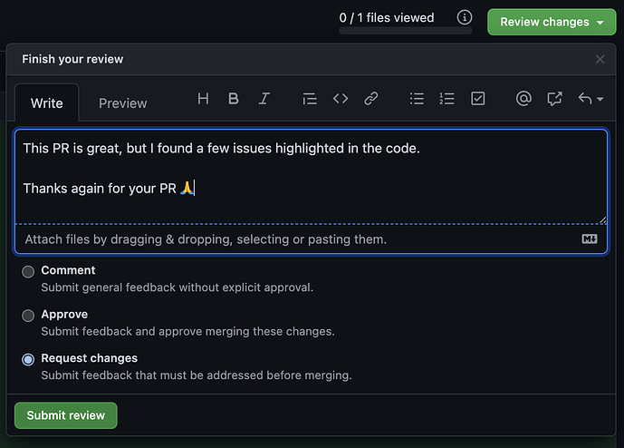

Then, once you’ve given all your feedback, you can write a small summary at the top and click on one of three possible statuses:
  • Comment: to make a comment on the PR
  • Approve: to say that the PR is good to go to production
  • Request changes: the PR is not good to go to production, there are issues to fix
It’s simpler for everyone if we use GitHub’s mechanisms :slight_smile:
