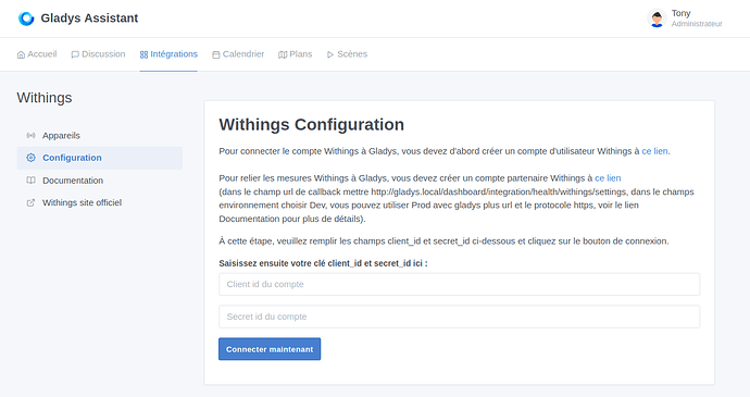

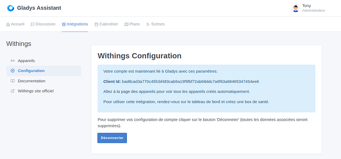

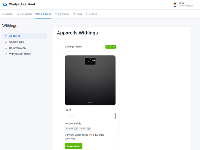

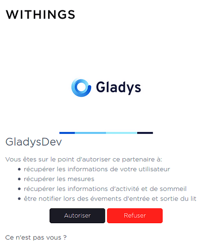

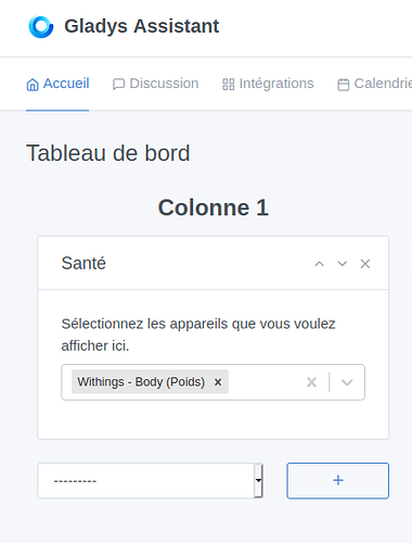

I’ve made significant progress on this development. I’ve just pushed a nearly final version of the PR [WIP] Withings.
This integration allows:
  • Connecting to the Withings account
  • A generic API (server & front) to connect to OAuth2 services (to be confirmed on other integrations)
  • Automatic creation of Withings devices
  • Retrieving device measurements
  • Displaying a ‹ Health › box in the dashboard similar to the DeviceInRoom box
The remaining tasks to consider the integration correct are:
  • Integration documentation (in progress)
  • Adding a configuration for the demo site
  • Code review if possible and taking into account the remarks
  • [Optional] Testing the integration by volunteers with more devices (the integration should work for all Withings devices, but I only have one for now)
Ideally, for a next version, I would have liked to display a box on the dashboard in the form of a line graph. Are there components already planned to display the history of data?
Some images of the integration:
