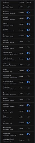

I’ve configured the services that are turned on

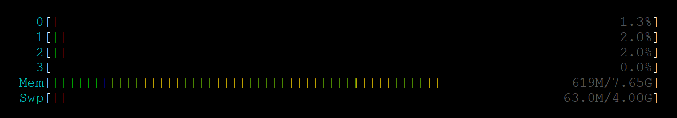

htop
You may need to install htop with:
apt-get install htop
Is your machine underwater or not?
I don’t get that impression at all
Ok, but right now is everything okay?
