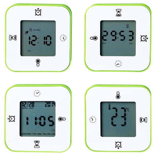

When I have time, I’ll listen to it, bought at iKea, I think there’s a chance the temperature sensor sends data:
