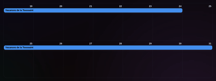

In October, I have the 25th twice, a Sunday and a Monday.

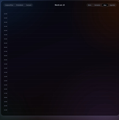

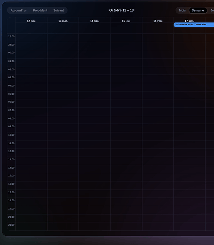

In the weekly view, the day goes from 10 p.m. to 9 p.m.
Same in the daily view

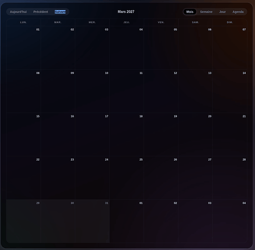

bug on Mars 2027 where the grayed-out days at the end of the month are incorrect.

1. In week and day views, the time gutter started at 22:00 instead of 00:00 β
shifted by the local UTC offset
2. In month view, a date appeared twice around the October DST switch (the
"25th shown twice, on the Sunday and on the Monday")
3. In month view, the last days of the month were greyed as out-of-range while
the first days of the next month looked in-range

β merge(date, min) β 00:00 local β 22:00 the day before (string reparsed as UTC) β

β add(25 Oct, 1 day) β 26 Oct 00:00 β 25 Oct 23:00 (24 absolute hours, but that day lasts 25) β

β startOf('month') on 30 March β 28 Feb 23:00 β 28 Feb 22:00 (an hour off past the DST switch) β
