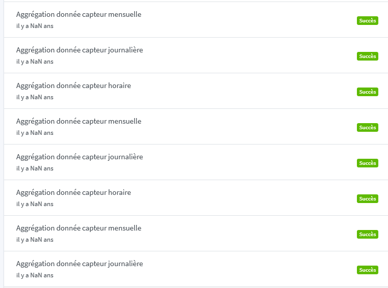

Dates displayed as NaN in the "Background Tasks" tab

Another thing:
I don’t understand why the execution « date » is never shown

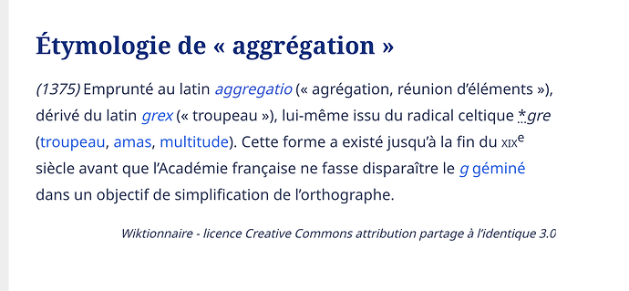

Also, there’s only one « g » in agrégation

Indeed, apparently both spellings exist (hence why spellcheckers don’t correct it), but the form with two g’s apparently is no longer used ^^
I learned something!
I’ll fix that
Same issue on my side
I think this is it:
[{\"id\":\"2e1faf4f-83c4-4ea8-a2e4-807bf84617fa\",\"type\":\"monthly-device-state-aggregate\",\"status\":\"success\",\"progress\":99,\"data\":{},\"created_at\":\"2022-12-19 15:02:25.401 +00:00\",\"updated_at\":\"2022-12-19 15:02:30.859 +00:00\"},{\"id\":\"d3398f75-218c-4adf-8154-25ba019bfcb7\",\"type\":\"daily-device-state-aggregate\",\"status\":\"success\",\"progress\":99,\"data\":{},\"created_at\":\"2022-12-19 15:02:19.655 +00:00\",\"updated_at\":\"2022-12-19 15:02:25.392 +00:00\"},{\"id\":\"d70fbd61-f4f7-43e8-abe2-16d4fdd522c3\",\"type\":\"hourly-device-state-aggregate\",\"status\":\"success\",\"progress\":99,\"data\":{},\"created_at\":\"2022-12-19 15:02:12.794 +00:00\",\"updated_at\":\"2022-12-19 15:02:19.645 +00:00\"},{\"id\":\"ae56e6a0-b9ba-40eb-906f-67ae4c862106\",\"type\":\"monthly-device-state-aggregate\",\"status\":\"success\",\"progress\":99,\"data\":{},\"created_at\":\"2022-12-19 14:02:26.049 +00:00\",\"updated_at\":\"2022-12-19 14:02:32.108 +00:00\"},{\"id\":\"4197d1c2-e3d7-4205-96e1-e914316f15b3\",\"type\":\"daily-device-state-aggregate\",\"status\":\"success\",\"progress\":99,\"data\":{},\"created_at\":\"2022-12-19 14:02:20.121 +00:00\",\"updated_at\":\"2022-12-19 14:02:26.040 +00:00\"},{\"id\":\"b3d84ceb-2b95-43af-ac7e-f82d823a5767\",\"type\":\"hourly-device-state-aggregate\",\"status\":\"success\",\"progress\":99,\"data\":{},\"created_at\":\"2022-12-19 14:02:12.793 +00:00\",\"updated_at\":\"2022-12-19 14:02:20.112 +00:00\"},{\"id\":\"632fca35-d94d-4986-a70c-82413d29b874\",\"type\":\"monthly-device-state-aggregate\",\"status\":\"success\",\"progress\":99,\"data\":{},\"created_at\":\"2022-12-19 13:02:24.973 +00:00\",\"updated_at\":\"2022-12-19 13:02:30.384 +00:00\"},{\"id\":\"1dc49208-ab7e-4435-9b10-42e1c8a64b01\",\"type\":\"daily-device-state-aggregate\",\"status\":\"success\",\"progress\":99,\"data\":{},\"created_at\":\"2022-12-19 13:02:19.720 +00:00\",\"updated_at\":\"2022-12-19 13:02:24.964 +00:00\"},{\"id\":\"ae611a59-a255-4382-b21a-3cf9474b28b9\",\"type\":\"hourly-device-state-aggregate\",\"status\":\"success\",\"progress\":99,\"data\":{},\"created_at\":\"2022-12-19 13:02:12.792 +00:00\",\"updated_at\":\"2022-12-19 13:02:19.711 +00:00\"},{\"id\":\"b165e458-5c34-4ac6-bcd7-9c15c53177b8\",\"type\":\"monthly-device-state-aggregate\",\"status\":\"success\",\"progress\":99,\"data\":{},\"created_at\":\"2022-12-19 12:02:22.755 +00:00\",\"updated_at\":\"2022-12-19 12:02:28.409 +00:00\"},{\"id\":\"8b198299-0298-4d8c-8f32-db7009e4b0b4\",\"type\":\"daily-device-state-aggregate\",\"status\":\"success\",\"progress\":99,\"data\":{},\"created_at\":\"2022-12-19 12:02:17.848 +00:00\",\"updated_at\":\"2022-12-19 12:02:22.747 +00:00\"},{\"id\":\"218b89e7-a17e-4b69-95fa-a9a51d46628e\",\"type\":\"hourly-device-state-aggregate\",\"status\":\"success\",\"progress\":99,\"data\":{},\"created_at\":\"2022-12-19 12:02:12.791 +00:00\",\"updated_at\":\"2022-12-19 12:02:17.833 +00:00\"},{\"id\":\"368e2e9b-2891-4c92-8dfc-9758cef7aff6\",\"type\":\"monthly-device-state-aggregate\",\"status\":\"success\",\"progress\":99,\"data\":{},\"created_at\":\"2022-12-19 11:02:23.096 +00:00\",\"updated_at\":\"2022-12-19 11:02:28.552 +00:00\"},{\"id\":\"7d7cd4f4-1bc0-4820-85f0-679df43ed539\",\"type\":\"daily-device-state-aggregate\",\"status\":\"success\",\"progress\":99,\"data\":{},\"created_at\":\"2022-12-19 11:02:18.213 +00:00\",\"updated_at\":\"2022-12-19 11:02:23.087 +00:00\"},{\"id\":\"519a7c51-752b-4bb1-8acc-ad506e50ed14\",\"type\":\"hourly-device-state-aggregate\",\"status\":\"success\",\"progress\":99,\"data\":{},\"created_at\":\"2022-12-19 11:02:12.789 +00:00\",\"updated_at\":\"2022-12-19 11:02:18.204 +00:00\"}]

Thanks for the snippet, I just tested on my side and I can’t reproduce it! :confused:
I looked at the code, and I really don’t see what could cause this bug…

I can reproduce it too, I figured out the bug :grin: the parsing of this date format works in Chrome but not in Safari or Firefox
You need to switch to a more standard format readable by all browsers, this can be done on the front end ^^
@cicoub13 if you want to make a small PR, otherwise I’ll do it :grinning_face_with_smiling_eyes:
So I took a look and I need an opinion before fixing.
According to the dayjs documentation, the library only accepts date parsing in the ISO 8601 format 2018-04-13 19:18:17.040+02:00
But the job dates are stored with this format YYYY-MM-DD HH:mm:ss.SSS Z (like 2023-01-20 20:39:46.089 +00:00) with a space.
I have no idea why Chrome and Safari work and not Firefox :man_shrugging:

Chrome’s date parser is more permissive :slight_smile: dayjs is just a wrapper around new Date(), if you compare across browsers, Chrome accepts formats that the others don’t.
