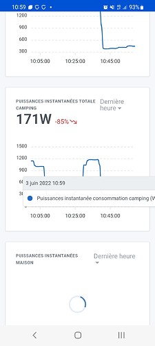

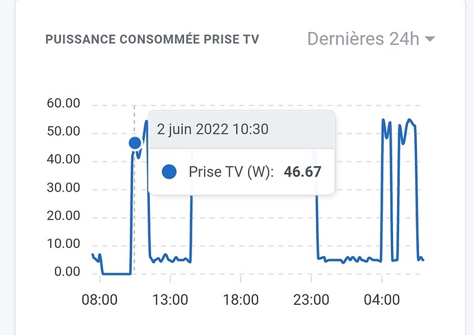

How is time handled in the graphs ?
Because I always have a 2-hour difference in the display of the curves.
In the graph you can see the first peak starting at 10:30 while it was actually around 12:30.

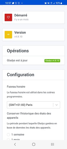

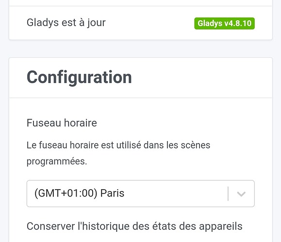

Have you properly configured your time zone in the settings?
Since I did that, I no longer have this issue:
Yes, I’ve checked

I have all the dates in GMT in the browser, hence the 2-hour offset
That’s not related, look at the body return, that’s a response header, it’s not used :slight_smile:

I checked in the database and we also have a 2-hour offset in the records
It was 12:21 instead of 10:21.
The time in the DB seems correct to me; in the database the data was recorded in the UTC timezone (indicated by the +00:00 at the end of the datetime, so indeed 2 hours before French time)
However, the frontend should be able to handle that and perform the conversion when displaying.
Can you check in the JSON body of the API response on the frontend what date format is being sent?

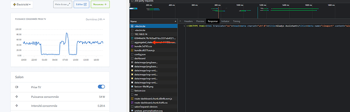

![image|690x222](upload://f9W1LgN6ih2d0WQbXkQ8G
Click on this request
Here you go
[{"device":{"name":"Prise TV"},"deviceFeature":{"name":"Puissance consommée"},"values":[{"created_at":"2022-06-05T17:30:00.000Z","value":49.33},{"created_at":"2022-06-05T17:40:00.000Z","value":44.75},{"created_at":"2022-06-05T17:50:00.000Z","value":49.67},{"created_at":"2022-06-05T18:10:00.000Z","value":46.5},{"created_at":"2022-06-05T18:20:00.000Z","value":43.71},{"created_at":"2022-06-05T18:40:00.000Z","value":50.43},{"created_at":"2022-06-05T18:45:00.000Z","value":43.29},{"created_at":"2022-06-05T19:10:00.000Z","value":49.29},{"created_at":"2022-06-05T19:15:00.000Z","value":46.33},{"created_at":"2022-06-05T19:35:00.000Z","value":44.71},{"created_at":"2022-06-05T19:40:00.000Z","value":54},{"created_at":"2022-06-05T20:00:00.000Z","value":42.67},{"created_at":"2022-06-05T20:15:00.000Z","value":53},{"created_at":"2022-06-05T20:35:00.000Z","value":39.47},{"created_at":"2022-06-05T20:40:00.000Z","value":53.5},{"created_at":"2022-06-05T20:55:00.000Z","value":44.38},{"created_at":"2022-06-05T21:15:00.000Z","value":52},{"created_at":"2022-06-05T21:30:00.000Z","value":44.45},{"created_at":"2022-06-05T21:40:00.000Z","value":46.13},{"created_at":"2022-06-05T21:50:00.000Z","value":52.67},{"created_at":"2022-06-05T22:05:00.000Z","value":5},{"created_at":"2022-06-05T22:25:00.000Z","value":5},{"created_at":"2022-06-05T22:35:00.000Z","value":6},{"created_at":"2022-06-05T22:50:00.000Z","value":7},{"created_at":"2022-06-05T23:05:00.000Z","value":5},{"created_at":"2022-06-05T23:25:00.000Z","value":7},{"created_at":"2022-06-05T23:35:00.000Z","value":4.5},{"created_at":"2022-06-05T23:50:00.000Z","value":6},{"created_at":"2022-06-06T00:05:00.000Z","value":4.5},{"created_at":"2022-06-06T00:15:00.000Z","value":5},{"created_at":"2022-06-06T00:35:00.000Z","value":6},{"created_at":"2022-06-06T00:40:00.000Z","value":5},{"created_at":"2022-06-06T01:05:00.000Z","value":5},{"created_at":"2022-06-06T01:15:00.000Z","value":6.5},{"created_at":"2022-06-06T01:25:00.000Z","value":5},{"created_at":"2022-06-06T01:40:00.000Z","value":5.4},{"created_at":"2022-06-06T02:00:00.000Z","value":5},{"created_at":"2022-06-06T02:15:00.000Z","value":4},{"created_at":"2022-06-06T02:20:00.000Z","value":5.5},{"created_at":"2022-06-06T02:35:00.000Z","value":5},{"created_at":"2022-06-06T03:00:00.000Z","value":5},{"created_at":"2022-06-06T03:15:00.000Z","value":6},{"created_at":"2022-06-06T03:30:00.000Z","value":50.75},{"created_at":"2022-06-06T03:35:00.000Z","value":55},{"created_at":"2022-06-06T03:45:00.000Z","value":47.73},{"created_at":"2022-06-06T04:00:00.000Z","value":54.5},{"created_at":"2022-06-06T04:25:00.000Z","value":54},{"created_at":"2022-06-06T04:35:00.000Z","value":43.34},{"created_at":"2022-06-06T04:55:00.000Z","value":47.86},{"created_at":"2022-06-06T05:05:00.000Z","value":53.6},{"created_at":"2022-06-06T05:20:00.000Z","value":87.33},{"created_at":"2022-06-06T05:25:00.000Z","value":71.13},{"created_at":"2022-06-06T05:50:00.000Z","value":66.88},{"created_at":"2022-06-06T06:00:00.000Z","value":57.35},{"created_at":"2022-06-06T06:10:00.000Z","value":5.8},{"created_at":"2022-06-06T06:25:00.000Z","value":5},{"created_at":"2022-06-06T06:45:00.000Z","value":5.5},{"created_at":"2022-06-06T07:00:00.000Z","value":4},{"created_at":"2022-06-06T07:05:00.000Z","value":5},{"created_at":"2022-06-06T07:25:00.000Z","value":6},{"created_at":"2022-06-06T07:35:00.000Z","value":4},{"created_at":"2022-06-06T07:50:00.000Z","value":6},{"created_at":"2022-06-06T08:15:00.000Z","value":5},{"created_at":"2022-06-06T08:25:00.000Z","value":46.45},{"created_at":"2022-06-06T08:35:00.000Z","value":55},{"created_at":"2022-06-06T08:55:00.000Z","value":55},{"created_at":"2022-06-06T09:10:00.000Z","value":49.6},{"created_at":"2022-06-06T09:20:00.000Z","value":55},{"created_at":"2022-06-06T09:35:00.000Z","value":52.78},{"created_at":"2022-06-06T09:55:00.000Z","value":54},{"created_at":"2022-06-06T10:00:00.000Z","value":44.87},{"created_at":"2022-06-06T10:15:00.000Z","value":51.8},{"created_at":"2022-06-06T10:30:00.000Z","value":47.6},{"created_at":"2022-06-06T10:45:00.000Z","value":55},{"created_at":"2022-06-06T11:05:00.000Z","value":47.07},{"created_at":"2022-06-06T11:10:00.000Z","value":45.54},{"created_at":"2022-06-06T11:25:00.000Z","value":51.4},{"created_at":"2022-06-06T11:50:00.000Z","value":54},{"created_at":"2022-06-06T12:00:00.000Z","value":48},{"created_at":"2022-06-06T12:05:00.000Z","value":54},{"created_at":"2022-06-06T12:20:00.000Z","value":47.47},{"created_at":"2022-06-06T12:35:00.000Z","value":45.33},{"created_at":"2022-06-06T13:00:00.000Z","value":53},{"created_at":"2022-06-06T13:10:00.000Z","value":48},{"created_at":"2022-06-06T13:20:00.000Z","value":54},{"created_at":"2022-06-06T13:40:00.000Z","value":47.83},{"created_at":"2022-06-06T13:50:00.000Z","value":54.33},{"created_at":"2022-06-06T14:05:00.000Z","value":49.76},{"created_at":"2022-06-06T14:25:00.000Z","value":55},{"created_at":"2022-06-06T14:30:00.000Z","value":45.96},{"created_at":"2022-06-06T14:45:00.000Z","value":49},{"created_at":"2022-06-06T15:10:00.000Z","value":45.69},{"created_at":"2022-06-06T15:20:00.000Z","value":50.33},{"created_at":"2022-06-06T15:30:00.000Z","value":54},{"created_at":"2022-06-06T15:45:00.000Z","value":45.4},{"created_at":"2022-06-06T16:00:00.000Z","value":54.4},{"created_at":"2022-06-06T16:20:00.000Z","value":48.91},{"created_at":"2022-06-06T16:25:00.000Z","value":54},{"created_at":"2022-06-06T16:40:00.000Z","value":54},{"created_at":"2022-06-06T16:55:00.000Z","value":47.62}]}]

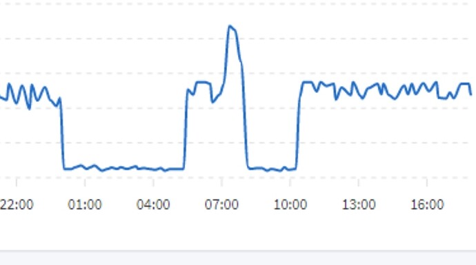

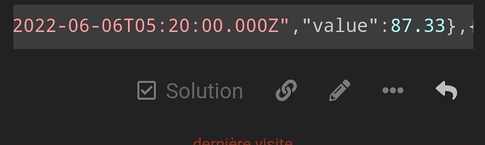

So, @_Will_71, is this the right time or not?
No, the time is not correct.
Here I have a peak at 5:20 which corresponds to French time 7:20.
We find this peak on the chart at about 7:20. So that matches.
But in reality it was 9:20!
