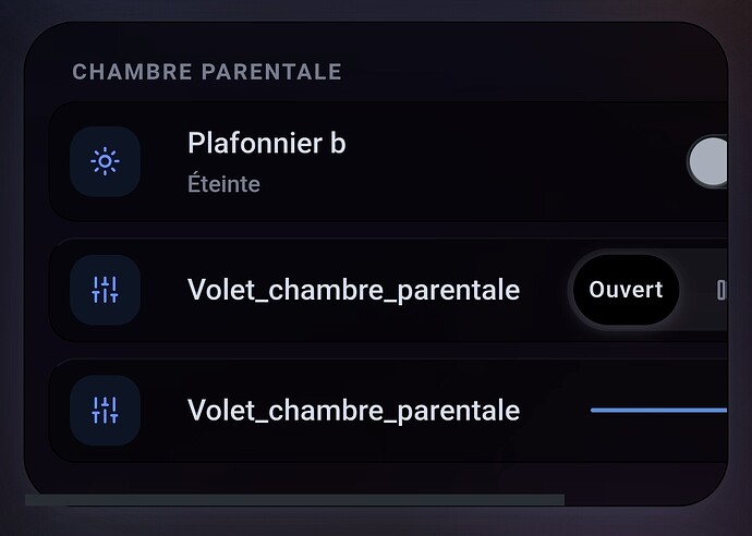

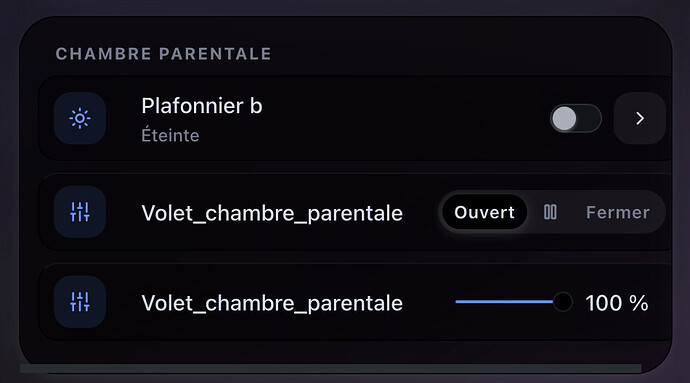

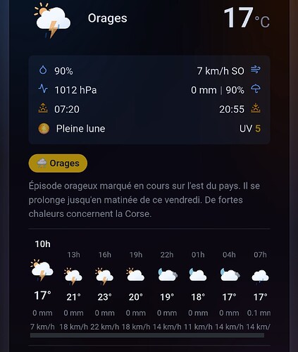

I have an issue with some cards, mobile or not, with horizontal scrolling.
Mobile:
Both:
mobile:
desktop:

A PR has been opened to fix the horizontal elevator on the dashboard cards (devices and weather):
master ← claude/bug-ascenseur-horizontal-6fazxt
ouvert 08:16AM - 28 Aug 26 UTC
### Description
Two dashboard widgets were reported on the forum as showing a h… orizontal scrollbar, on a phone and on a narrow desktop dashboard column alike.
**Devices widget** — an auto-layout table sizes a column to its widest unbreakable word, and a device name is very often one long token (`Volet_chambre_parentale`). That minimum pushed the whole table past the card, so `.table-responsive` put the row under a horizontal scrollbar with its controls cut off at the card edge. The name column now drops out of the table's minimum-width computation (`max-width: 0`) and ellipsizes instead, keeping the half of the row it had while the controls keep the width they ask for.
This also unblocks the adaptive option controls (`acAdaptiveControls`): they collapse to dropdowns *while the card overflows*, so a name that overflowed whatever they did was quietly turning every button group of the card into a dropdown for nothing.
The new rules are scoped to a `device-widget-table` class, because the devices page shares `device-list-table` but lays its rows out on six columns.
**Weather widget** — the hourly and daily forecast rows scroll sideways on purpose (the slots keep a readable floor rather than being crushed), but they carried a permanent scrollbar drawn across the card, which is what reads as broken. They get the treatment the app's other sideways rows already use (`.hz-tabs`, `.groupChips`): the bar is hidden, and a thin one comes back on hover or keyboard focus for mouse users. The rows still scroll.

And for the weather widget, you hide the scrollbar?
