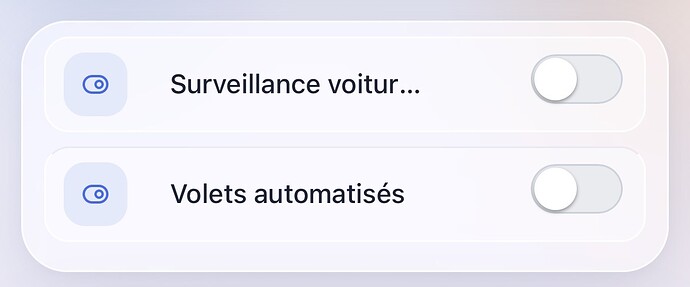

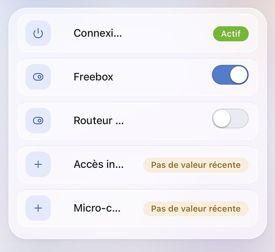

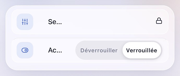

I had reported this issue for scenes and it’s already been fixed, but there’s the same phenomenon with MQTT devices: their name is truncated on my iPhone.
It’s either because the name is a bit long, or because the info is very wide. A few examples:
