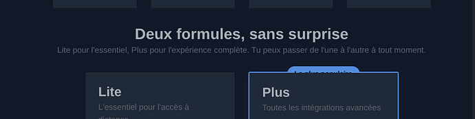

And now I’m fixing the part below for Gladys Plus. The text « Most popular » is hidden

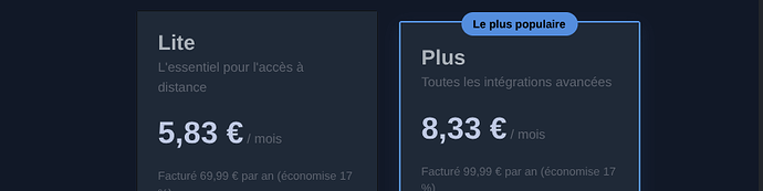

And the correction
I’ll put the PR in this week
