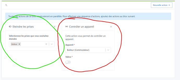

I am reporting a bug that took me some time to understand and concerns changing the status of an On/Off button via a scene.
There are 2 ways to change the status of On/Off switches in Gladys scenes
In both cases, the action is correctly performed on the device.
The bug is not present when the switch is set to On.
However, when the switch is set to Off, everything works with the green option, but in the red option, the Off status does not update in the Gladys dashboard, even though the action is correctly performed.
Thank you :slight_smile:

Yes, that’s the bug we see in my video with pierre-gilles from yesterday
At the time of the video, I had made the configuration in red on the screenshot, and since I made the configuration in green, no more problems
At that moment in the video
