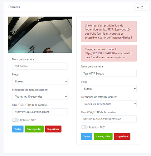

I set up an RTSP video stream, it works fine. However, the same HTTP stream that I can play in my browser does not work and returns an error.

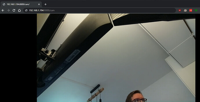

HTTP stream visible though:
What happens if you remove the last slash?
For the Raspberry Pi cameras, I right-clicked on the image in Chrome (http stream) and copied the link. Without that, it’s impossible to access the stream…
http://192.168.1.241/ doesn’t work but http://192.168.1.241/cam_pic.php?time=1674146902851\u0026pDelay=40000 works…
A good test if you want to check that a stream works is to test it with VLC before putting it into Gladys :slight_smile:
I made a tutorial in the documentation:
In my opinion, as @GBoulvin said, there you are accessing a web page, not an HTTP stream. The result of that route must be HTML, not an image
Indeed, looking in the « network » tab I see that it’s a stream over WebSockets.

To conclude on the subject, I discovered that the server I use also offers an HTTP video stream, without WebSockets, so compatible with Gladys!
I indeed had to look in the browser’s « Network » tab to find the correct URL, which looks like this: http://192.168.1.84:8888/cam/stream.m3u8
