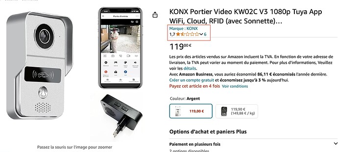

When you look at the Amazon rating for this device, the comments seem to point in the same direction ^^
