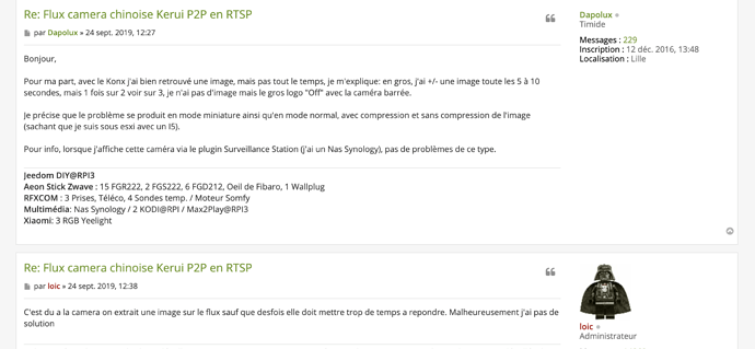

I have a Chinese camera that is compatible with RTSP stream, but here’s the thing, when I install it on my smartphone with the Yosee app, I no longer have access to the camera stream on Gladys. Is this normal, or am I not using the correct video stream? Here is my stream: rtsp://admin:pwd@192.168.1.100:554/onvif1. (I have indeed replaced the admin and the pwd). With this stream, I do get an image, but either on Yosee or on Gladys. It’s a Kerui Z05H-20 camera.
Thank you for your help
@Psoy It would be worth checking the model online to see if other users have similar issues, it seems like the camera can only handle a single stream :stuck_out_tongue:
Otherwise, you can connect it only to Gladys, and view the stream on your phone or via the Telegram integration (in mode: « Show me the living room camera » I don’t know if you’ve already tested it)
I didn’t specify, but it’s a motorized camera and I need the app. But I wanted to know if single-stream cameras exist, or if I’m not taking the right stream.
I don’t necessarily think it’s a « single-stream » camera, I think it’s a fairly low-end camera with very little power, and therefore it can’t respond quickly enough to 2 clients at the same time!
An internet search confirms this theory:
https://forum.jeedom.com/viewtopic.php?f=91&t=46007&sid=faf6095b53f45f5dbfbafe32526c154c&start=20
