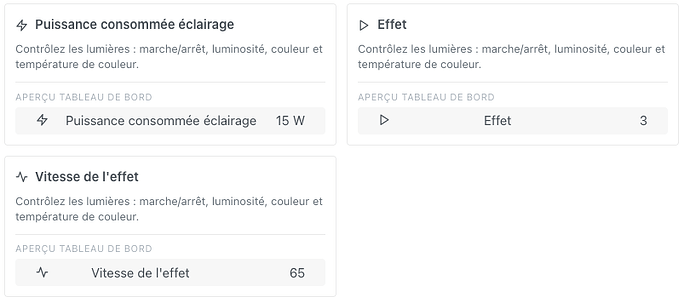

I launched a Cursor agent on the topic, and it developed this catalog for me, the result is really clean ![]()

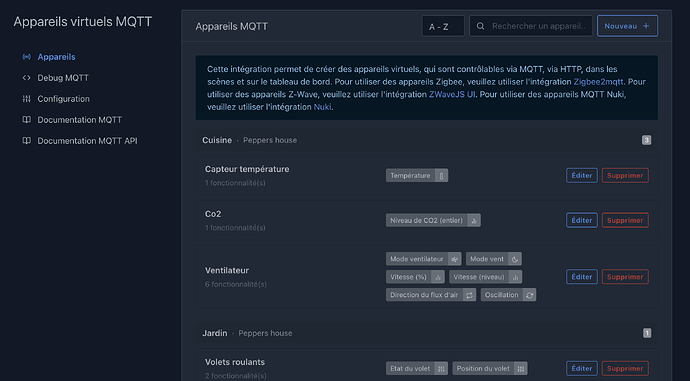

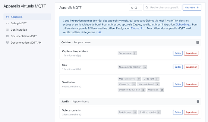

List of MQTT devices:

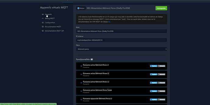

Editing an MQTT device:

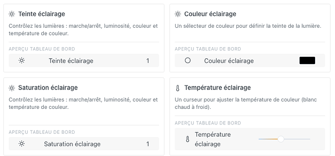

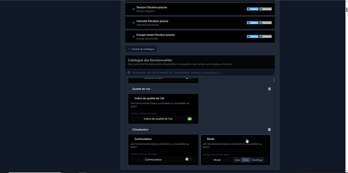

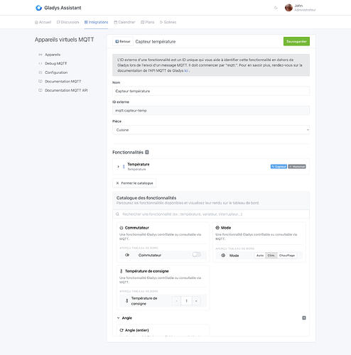

Adding a new feature with the catalog:
The catalog displays the final rendering of each feature, so it’s very clear.
I really like the result ![]()
If you ever want to test the PR:
It’s even possible via Gladys Plus on an existing instance, since it’s pure frontend:
https://cursor-mqtt-virtual-device-u.gladys-plus.pages.dev/
Feedback welcome!

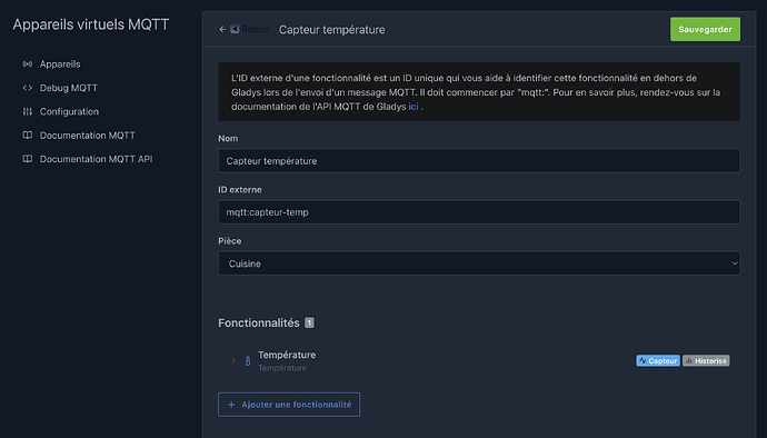

Dark mode, the black a bit too gloomy:

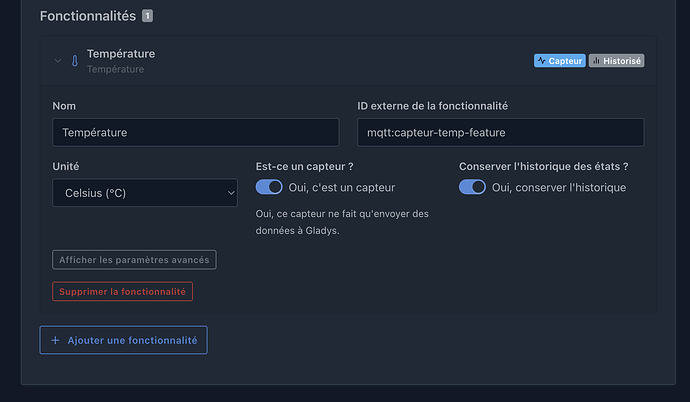

A very practical UX improvement, the external ID is now automatically filled in, with the device name and a few random characters to avoid collisions:
And it also works on features:
The new MQTT catalog is merged and will be included in the next version of Gladys ![]()
Sorry, couldn’t test earlier and so I have some feedback…
Small remark about the search, accents are absolutely necessary ![]()
Speed level: no % for me as we already have a speed (%)
Leak: it’s a sensor, not a switch for me
Brightness: add % as a unit
Hue and saturation: issue with the legend and control?

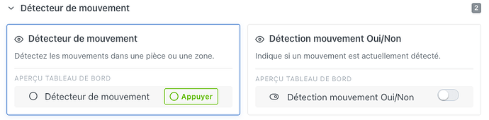

Motion detector: yes/no sensor and not a controller, active/inactive motion detection (instead of press)

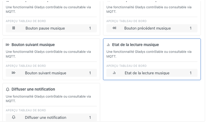

For music, I’ve always had issues with these sensors that should be controllers, right (except state)? For TV, we have Press.
Opening: sensor and not switch
pH: no unit for me
Detectors in general: yes/no sensor and not Press or switch
Shutter position: unit in %
Then the anti-theft for the sockets, I didn’t understand
If it’s the child lock, it’s an on/off switch
Energy consumed: unit in kWh
UV sensor: no unit
Angles: unit °
COV NO2 indices: either we remove (integer), or we put an integer
Input state: sensor or switch?
Well, sorry again for the check and tests being so long ![]()
Otherwise, the previews for the dashboard are really great and ultra-explicit, and that’s awesome ![]()
