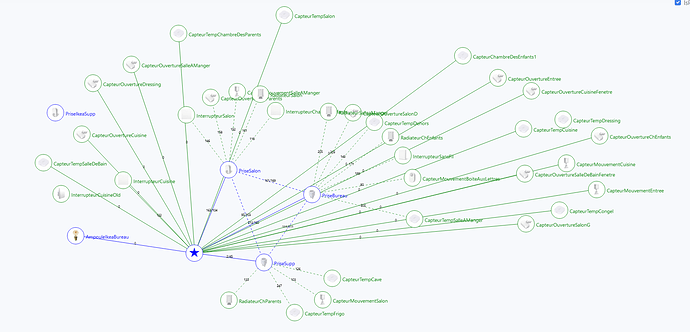

From experience, I’ve noticed that Aqara devices never use the Zigbee mesh, always connecting directly to the coordinator even if a Hue bulb acting as a relay is right next to it.
(For those wondering, image retrieved from http://:8080, which is the Zigbee2MQTT interface, the project that Gladys uses for Zigbee)
This isn’t entirely true for me, I have quite a few sensors that use my living room outlet and the one in my office, even though most are Xiaomi. But the vast majority use my Zigbee key, also because I didn’t have the outlets at the beginning.
If I’m not mistaken for Aqara, if the sensor has been paired with the coordinator, even if it is closer to a router, it will continue to be connected to the coordinator (source: I don’t remember!).
