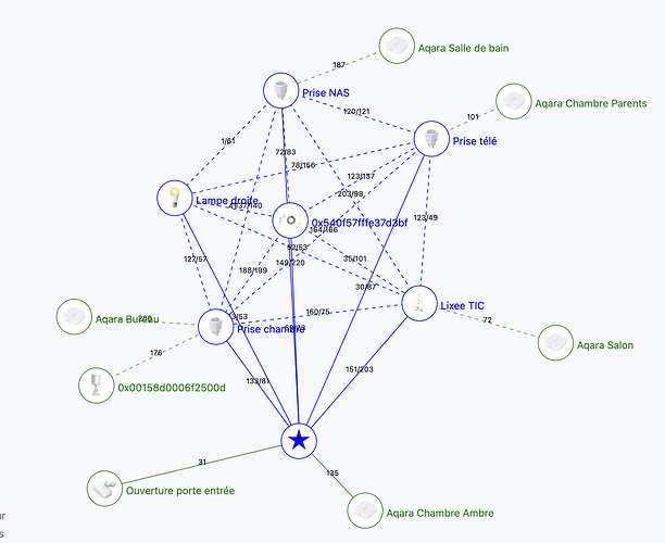

I have just purchased this model, mainly to extend the Zigbee mesh but I notice that the reception levels reported by my other devices are not changing.
SONOFF S26R2ZBTPE - 16A Zigbee 3.0 Smart Plug Type E (espace-domotique.fr)
My Zigbee dongle
SONOFF - Zigbee 3.0 USB dongle + external 20dBm antenna (V2) ZBDongle-E (domadoo.fr)
Have I missed something, please?
Thanks!
We’ve already noticed this problem. Actually, it seems that you only have the ‹ direct › connection level from the dongle and not via the mesh…
Look on the ZigBee2MQTT container page, there’s a really useful, more complete diagram…
You can try removing an end device and re-pairing it close to your outlet.
And as @GBoulvin says, the diagram makes it easier to understand your network (accessible at http://192.168.1.9:8080/#/map)
